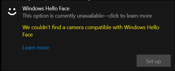

  1. is there windows hello face recognition DELL Insprion: 5593 and how to add it
    In my inpiron there is windows hello fingerprint, pin and my camera is also working fine but my windows hello face recognition is not working it is showing

  2. How to set up face recognition in dell Inspiron 5593 and which drivers are needed for it
    How i set up face recognition for my dell Inspiron 5593.
    When i click on the face recognition option it is saying that we could not find a camera compartable to windows hello.
    If any drivers are needed plz. tell me.

  3. Windows Hello Face Recognition Set up
    Please provide us below details to assist you better,
    • How exactly you are trying to setup Windows Hello Face Recognition?
    • What is the error you are getting, while trying to setup Windows Hello Face Recognition?
    A regular webcam will not work with Windows Hello. Windows 10 features Windows Hello, which provides new ways to authentication using biometrics including facial recognition.
    Since this is essentially 3-d detection, a camera with a specialized illuminated infrared camera is required.
    I suggest you to try the below steps to setup Windows Hello Face Recognition and check if it helps.
      • Open up "Settings" and click on "Accounts," then "Sign-in options."
      • You need to set up a PIN code before you're allowed to use Windows Hello. So hit the "Add" button under "PIN" to set that up. Once you've done that the options to set up Windows Hello will unlock.
      • You'll now see which options are available to set up under Windows Hello, Since we're looking at facial unlock you'll see an option for "Face." Click on "Set Up."
      • The next screen will give you a little background on what Windows Hello is. Click on "Get started".
      • The next step could happen incredibly quickly. Position yourself so your face is in the center of the frame that appears on screen. The camera will then do what it needs to do to register your face.
      • Once you're set up you have an option that allows you to improve recognition.
      • Now, when you go back to Settings you'll have the option again to improve recognition, remove your face, a toggle to turn on unlocking your PC when it sees your face and an added security option that will require you to turn your head
        left and right for verification.
