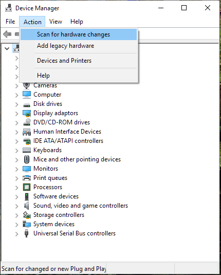

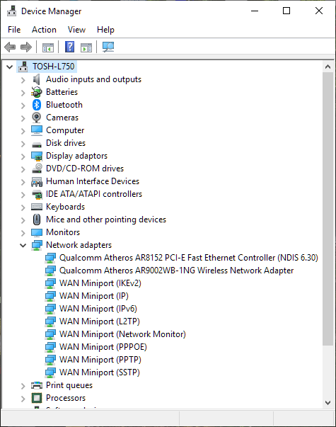

    How did you try to uninstall the wired network? I have done just that on my own Toshiba L750 and (as I'm posting from it now) you can see I survived to the the tale. This is what I did....
    Go into Device Manager and click on Network adapters to expand the list. For all entries under Network Adapters, right-click on each and select 'Uninstall'. Then click 'Action > Scan for hardware' changes and Window should load all the correct drivers.
    Here I am with no network adapters....
    Is Windows 10 not compatible with Toshiba Satellite L755? Or, does anyone know if the issue... 227022d1552348039t-toshiba-satellite-l755-s5153-windows-10-drivers-tosh-no-network.png
    ...and after scanning for new hardware they are all back and functioning, Ethernet and WiFi (I tested both).
    Is Windows 10 not compatible with Toshiba Satellite L755? Or, does anyone know if the issue... 227023d1552348127t-toshiba-satellite-l755-s5153-windows-10-drivers-tosh-scan-devices.png
