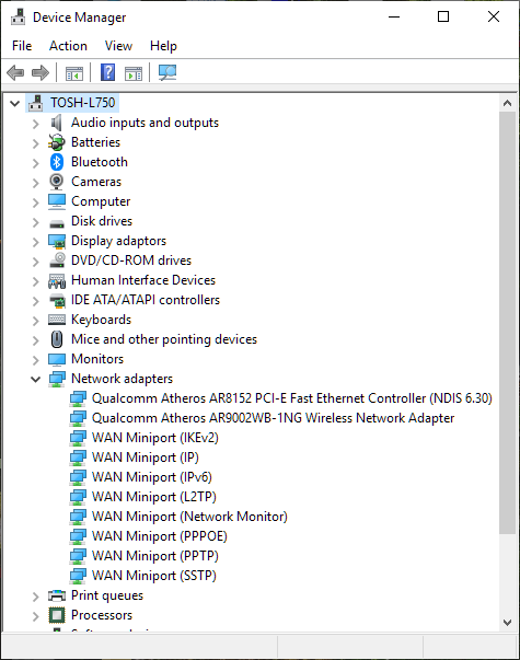

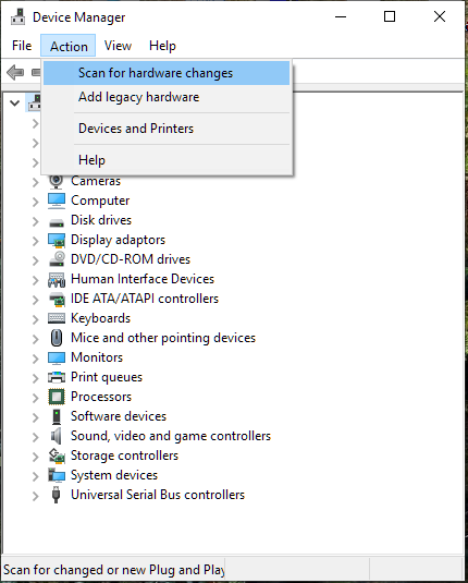

    How did you try to uninstall the wired network? I have done just that on my own Toshiba L750 and (as I'm posting from it now) you can see I survived to the the tale. This is what I did....
    Go into Device Manager and click on Network adapters to expand the list. For all entries under Network Adapters, right-click on each and select 'Uninstall'. Then click 'Action > Scan for hardware' changes and Window should load all the correct drivers.
    Here I am with no network adapters....
    Is Windows 10 not compatible with Toshiba Satellite L755? Or, does anyone know if the issue... 227022d1552348039t-toshiba-satellite-l755-s5153-windows-10-drivers-tosh-no-network.png
    ...and after scanning for new hardware they are all back and functioning, Ethernet and WiFi (I tested both).
