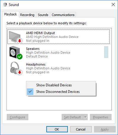

    Since you seem to be able to connect to the speaker via bluetooth, the next thing I would check is what Audio Playback device is set as the default. To check this, navigate to Control Panel > Hardware and Sound > Sound and you will see a box that looks like this:
    Issue with Bluetooth Speakers Connected but not listed in sound devices on Windows 11 l5U66.png
    You should see the connected bluetooth speaker listed on the playback device list. Right click on the device and select "Set as default device". You can also right click the device and select "test" to send a test chime to the speaker. If you right click the device and select "Properties", there may be a tab for "Levels" which allows you to set the volume output from the computer (not sure whether bluetooth devices have this option). Lastly, ensure the volume on the speaker itself is loud enough to hear.
