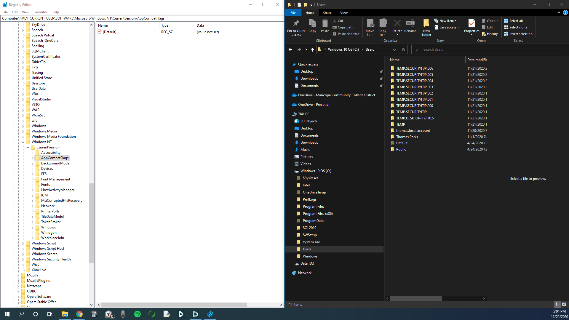

    Hello
    I was having issues yesterday trying to change my User account from "Thoma" to "Thomas Parks" as you can see in the screenshot Right. I was successful after I renamed the .bat file in ProfileList screenshot on left and deleted the original profile. I can now login to "Thomas Parks" as Admin since I'm the only one who uses this laptop. I've noticed a few things after I was able to log off and log back into the laptop from Windows Hello Screen/Welcome screen:
    1. Removal of temporary user accounts:
    a. How do I safely remove all the "TEMP.SEUCURITYITJP.00x", the "TEMP.DESKTOP-T7JFKES" old name of my computer before I renamed it "SecurityITJP", "TEMP" and "thomas.local.account" this account I created to login so I can change the initial user account folder in the Users folder on C: drive. "Thoma" to "Thomas Parks".
    2. Drill down to Computer\HKEY_CURRENT_USER\SOFTWARE\Microsoft\Windows NT\CurrentVersion so I can access the profiles in the missing "ProfileList" folder in my registry.
    a. How do I fix the registry Left Screenshot so can proceed with removing these temporary profiles and only have the profile I login on a daily basis that being the "Thomas Parks" account.

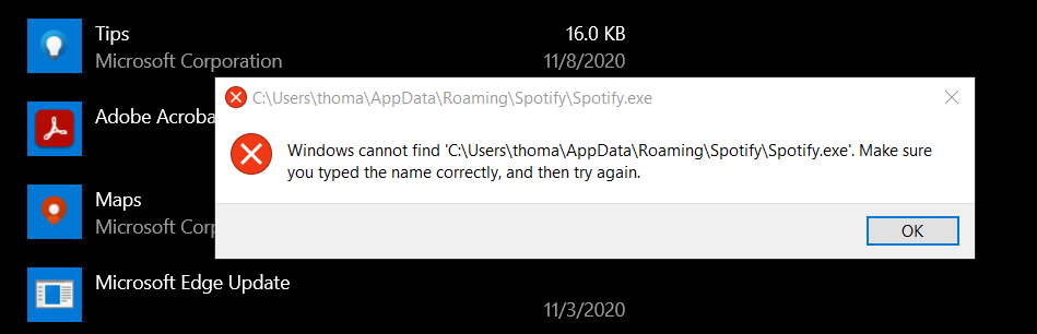

    3. An unforeseen issue was when I went to open Python IDLE 64-bit to start a Python assignment for my class, it didn't want to open and gave me an error when I attempt to reinstall because the system shows it in my old location on the D: drive which please see screen shot directly below:
    Issue with NO "ProfileList" path in Registry for my Windows 10 Home - HP Envy Laptop 52e2a617-16b5-4ec8-b9ba-41fdfe75a8ed?upload=true.png
    Screen shot of Registry vs. Users in C: Drive:
    Issue with NO "ProfileList" path in Registry for my Windows 10 Home - HP Envy Laptop de5bade1-75b7-4c90-9713-645d16482e21?upload=true.png
    Thank You in advanced good thing is I can work around this at the moment
