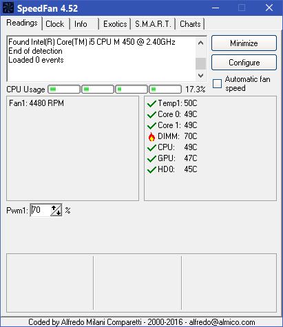

  2. BRAC Win User
    Upgrade to 1803 version fails with 0xc1900101-0x30017 error
    I've found solution for error 0xC1900101 0x30017 FIRST_BOOT during BOOT after trying to... 189161d1526593437t-upgrade-1803-version-fails-0xc1900101-0x30017-error-overview.jpg
    I've found solution for error 0xC1900101 0x30017 FIRST_BOOT during BOOT after trying to... 189163d1526593458t-upgrade-1803-version-fails-0xc1900101-0x30017-error-temperature.jpg
    I've found solution for error 0xC1900101 0x30017 FIRST_BOOT during BOOT after trying to... 189164d1526593477t-upgrade-1803-version-fails-0xc1900101-0x30017-error-smart.jpg
    I've found solution for error 0xC1900101 0x30017 FIRST_BOOT during BOOT after trying to... 189165d1526593497t-upgrade-1803-version-fails-0xc1900101-0x30017-error-disk-performance.jpg
    Speed Fan
    I've found solution for error 0xC1900101 0x30017 FIRST_BOOT during BOOT after trying to... 189167d1526593757t-upgrade-1803-version-fails-0xc1900101-0x30017-error-speed-fan.jpg
