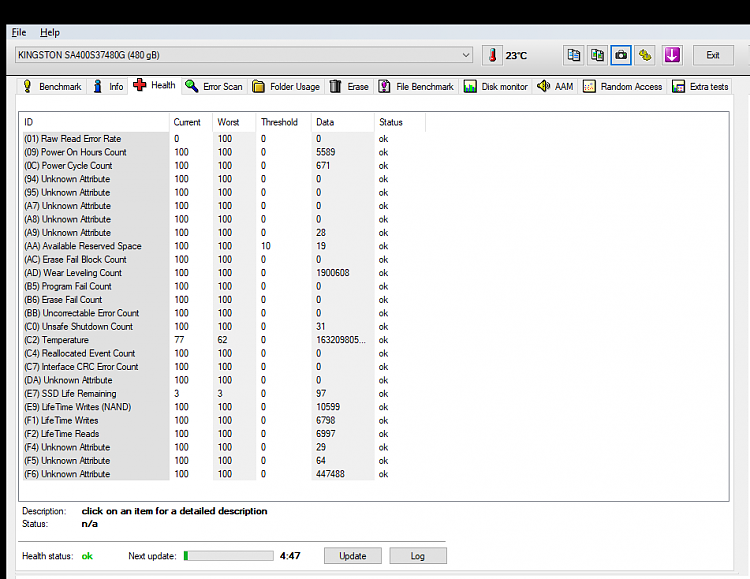

    HD Tune Pro:
    - Error Scan for both SSDs resulted in green squares
    - Health status is "ok" for both SSDs
    - KINGSTON SA400S37480G Benchmark (First SSD)
    Test capacity: full
    Transfer Rate Minimum : 3.4 MB/s
    Transfer Rate Maximum : 100.1 MB/s
    Transfer Rate Average : 29.7 MB/s
    Access Time : 0.964 ms
    Burst Rate : 72.7 MB/s
    CPU Usage : 3.8%

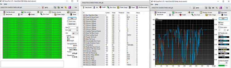

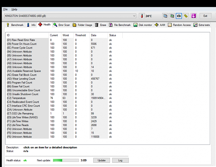

    - KINGSTON SA400S37480G Benchmark (Second SSD)
    Test capacity: full
    Transfer Rate Minimum : 5.4 MB/s
    Transfer Rate Maximum : 402.5 MB/s
    Transfer Rate Average : 231.0 MB/s
    Access Time : 0.206 ms
    Burst Rate : 64.3 MB/s
    CPU Usage : 2.7%

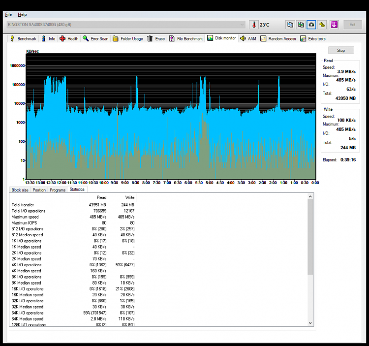

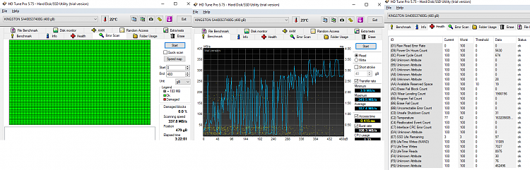

    And this is HD Tune. Sorry for the delay, I have a few busy days ahead so I'll upload the memtest ASAP. However, I have two things I want to mention in the meantime. First of all, I didn't have any BSODs in the past few days and the only thing I've changed was to move the keyboard from a USB port to another. Second of all, there was a technician who mentioned the following errors:
