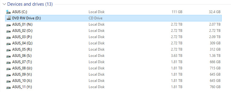

  3. Windows 10 thinks my dvd-rw is a cd-rom
    The operating system (Windows 10) sees my DVD-RW ans a CD-ROM.
    JACD-ROM/DVD-ROM/CD-RW/DVD+CDRW/DVDRW driver and close event no longer frozen 8d53492f-3ec8-4a83-b732-685e713e7b07.jpg
    This question has been posted to Microsoft by others, but the answer given has not been satisfactory. For instance, the Microsoft representative has asked that the user visit the manufacturer's website to get the latest driver.
    However, the driver for any DVD-RW is already in the Windows 10 operating system. The problem is that the OS recognizes the device as a CD-ROM and installs the driver for a CD-ROM.
    Driver Name: cdrom.inf
    Here are some things that do not work
    1. Uninstall the CD-ROM from Device Manager and reboot. That just gets the CD-ROM reinstalled.
    The first event is Windows 10 noticing that the device is not present
    Device SCSI\CdRom&Ven_ASUS&Prod_DRW-24B1ST___j\5&1c21ec16&0&000000 could not be migrated.
    Last Device Instance Id: SCSI\CDROM&VEN_ASUS&PROD_DRW-24B1ST___C\4&19BF6B6&0&050000
    Class Guid: {4d36e965-e325-11ce-bfc1-08002be10318}
    Location Path:
    Migration Rank: 0xF000EC000000F120
    Present: false
    Status: 0xC0000719
    Then Windows configures the device as a CD-ROM
    Device SCSI\CdRom&Ven_ASUS&Prod_DRW-24B1ST___j\5&1c21ec16&0&000000 was configured.
    Driver Date: 06/21/2006
    Driver Version: 10.0.10586.0
    Driver Provider: Microsoft
    Driver Section: cdrom_install
    Driver Rank: 0xFF0005
    Matching Device Id: GenCdRom
    Outranked Drivers:
    Device Updated: false
    Parent Device: PCI\VEN_1B4B&DEV_9215&SUBSYS_92151B4B&REV_11\4&97b900&0&00E7
    And finally it puts the "CD-ROM" back online
    Device SCSI\CdRom&Ven_ASUS&Prod_DRW-24B1ST___j\5&1c21ec16&0&000000 was started.
    Service: cdrom
    Lower Filters:
    Upper Filters:
    2. Try a third-party Disk-Burner. NERO Express only sees the drive as a CD-ROM and will not burn a DVD-RW
    3. Sometimes the laser burns out in the DVD and only the CD laser still works. I replaced the DVD-RW with an identical model (ASUS DRW-RW-24B1ST) and reproduced all the symptoms.
    4. Try the Microsoft Fix-It. That only works for Windows 7.
    So... assuming Microsoft really does have a fix for this issue, please disclose it.
