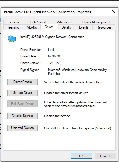

    been dealing with this same problem like for ever after the last os updates i think.
    here it the only true solution
    problem at start-up: 85279v gigabit network device wont start up
    so you either reboot the system or disable and re enable the device to get it to work right?
    thats what ive been doing .
    this reference is for the old school pc users remember "enhanced drivers" special driver made by the hard ware companies ? the they got rolled into windows so you didn't need drivers ? well that's the problem
    i installed the gigabyte drivers the 82579LM not the 82579V driver for the network card that came on the cd that was shipped with the motherboard.
    the drivers have a date that is marked 2013
    no issues as you can see in the pic
    so somewhere between 2013 and the last few os updates something was added or deleted in the os updates that makes the driver not work at boot up this is not an Intel error but a Microsoft error.
    full power down and the next day powered on booted up and network card was working like it should
