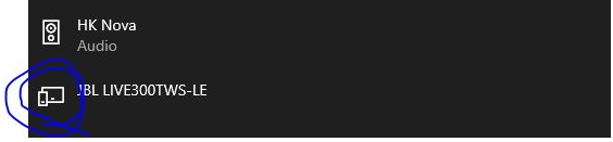

  3. JBL Headphones not recognised as audio via bluetooth
    Hi!
    I'm trying to connect my JBL Headphones 300tws to my ASUS laptop with windows 10. It does see them, but doesnt recognise them as headphones, but as a smartphone as you can see in the screenshot. So I can't use them with my laptop.
    JBL Headphones not recognised as audio via bluetooth 59539520-206a-4a2c-a2d7-61ef2086053c?upload=true.png
    I also have a JBL speaker, this connects with windows fine and is automatically recognised as a speaker.
    The headphones work great with my phone so it seems to be a windows problem. I've checked the bluetooth drivers for updates and tried to forget all devices and try again, but nothing has worked so far.
    Hope anyone can help me, thanks!
    Yara van Boven, Feb 24, 2023
  4. JBL Headphones not recognised as audio via bluetooth
    Hi Yara,
    I got the same trouble. I found the solution in the JBL site Bluetooth Pairing Guide. Remember to delete the jbl 300tws entry from the bluetooth devices list before you begin the procedure.
    You must put the Jbl 300TWS back in its case and then follow the instructions from the JBL page.
    Hope have helped you,
    Anibal
    Anibal Silva_611, Feb 24, 2023
