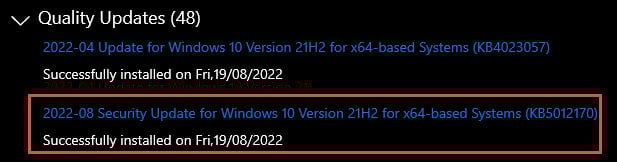

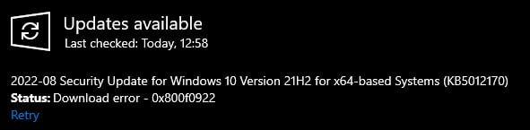

    Hello.Immediately I write that I use Google translator.I myself live in Russia, but I am writing here, because apparently the Russian support is dead.sryA lot of people already know a rather old problem with the security update - KB5012170, which led to an error - 0x800f0922.Until today, I, too, was her hostage.But today it miraculously disappeared, the update installed, and the notification of an important

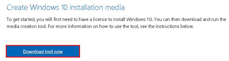

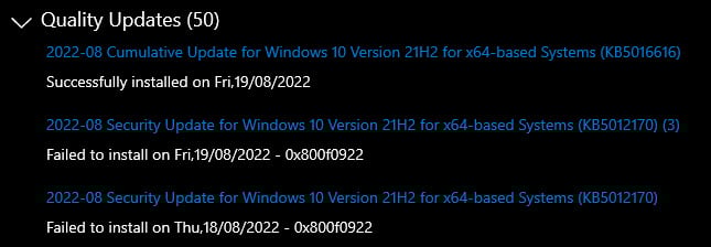

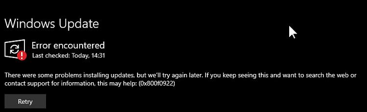

    Run the .bat file as instructed but did not solve the issue.
    KB5012170 - install error 0x800f0922.Possible solution to the problem. 373552d1660916052t-windows-update-kb5012170-error-0x800f0922-2022-08-19_14-32-32.jpg
    I will now try the Windows Installation Media and see if that helps.
    - - - Updated - - -

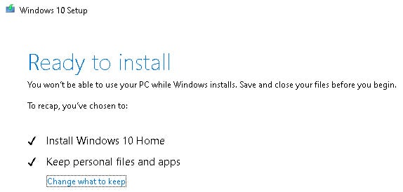

    Issue resolved by creating Windows 10 installation media
    KB5012170 - install error 0x800f0922.Possible solution to the problem. 373557d1660923053t-windows-update-kb5012170-error-0x800f0922-2022-08-19_14-48-50.jpg
    and installing Windows 10
    KB5012170 - install error 0x800f0922.Possible solution to the problem. 373558d1660923120t-windows-update-kb5012170-error-0x800f0922-2022-08-19_15-01-54.jpg
    Windows Update kb5012170 installed at the first attempt.
