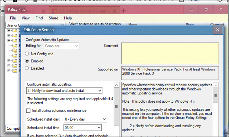

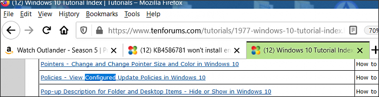

  3. dalchina Win User
    KB4586781 won't install error 0x80073701
    Sounds like you've set updates to Notify.
    You can view configured updates quite readily - tutorial available.
    KB5031455 update  why will not install and  0x80073701 install error 308156d1606416190t-kb4586781-wont-install-error-0x80073701-1.png
    If you don't know how to navigate to that policy, Policy Plus (free) has a useful 'Find' feature:
    KB5031455 update  why will not install and  0x80073701 install error 308155d1606415960t-kb4586781-wont-install-error-0x80073701-1.png
    You can try Tweaking.com's tool, if if still no joy, proceed to the next step, which as Tekkie Boy indicated would be an in-place upgrade repair install which keeps all progs and data, or just do that anyway.
    They should have no impact on group policy settings.
    dalchina, Nov 8, 2023
