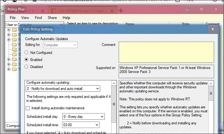

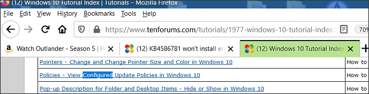

    Sounds like you've set updates to Notify.
    You can view configured updates quite readily - tutorial available.
    KB5031455 update  why will not install and  0x80073701 install error 308156d1606416190t-kb4586781-wont-install-error-0x80073701-1.png
    If you don't know how to navigate to that policy, Policy Plus (free) has a useful 'Find' feature:
    KB5031455 update  why will not install and  0x80073701 install error 308155d1606415960t-kb4586781-wont-install-error-0x80073701-1.png
