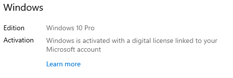

    Hi
    I have issue installing KB5032189 and it kept returning error 0x800f0922. I tried many ways to resolve this. I read sppinstaller is due to windows key. I recently changed my SSD and I am using the same key i had from my spoilt SSD but not sure if it is the case. How do i fix this?
    But my key is attached to my account
    KB5032189 failed to install 0x800f0922 hjQPspHqpr69FQkhJ%2B2WK%2FDKZFExPpu%2FSDiqYpQurORCaU9U8KUV4Je6Iu69%2F4YiBIFpTsdcte2qOZdjcPuy0%3D.png
    From CBS file:
    2023-12-22 09:17:40, Error [0x01803c] CSI 0000240e (F) Failed execution of queue item Installer: SppInstaller ({1b265fd2-721c-4e59-ad55-9d102a5d1d7f}) with HRESULT c004f01f [Error,Facility=FACILITY_ITF,Code=61471 (0xf01f)]. Failure will not be ignored: A rollback will be initiated after all the operations in the installer queue are completed; installer is reliable[gle=0x80004005]
    2023-12-22 09:19:11, Error CBS Startup: Failed to process advanced operation queue, startupPhase: 0. A rollback transaction will be created. [HRESULT = 0x800f0922 - CBS_E_INSTALLERS_FAILED]
    2023-12-22 09:19:11, Info CBS Setting ExecuteState key to: CbsExecuteStateInitiateRollback | CbsExecuteStateFlagAdvancedInstallersFailed
    2023-12-22 09:19:11, Info CBS SetProgressMessage: progressMessageStage: -1, ExecuteState: CbsExecuteStateInitiateRollback | CbsExecuteStateFlagAdvancedInstallersFailed, SubStage: 0
    2023-12-22 09:19:11, Info CBS Progress: UI message updated. Operation type: Update. Stage: 1 out of 1. Rollback.
    2023-12-22 09:19:11, Info CBS Setting original failure status: 0x800f0922, last forward execute state: CbsExecuteStateResolvePending
    2023-12-22 09:19:11, Info CBS Attempting to remove poqexec from SetupExecute
    2023-12-22 09:19:11, Info CBS Removed poqexec from SetupExecute.
    2023-12-22 09:19:11, Info CBS Configured poqexec to not pend to SetupExecute.
    2023-12-22 09:19:11, Info CBS Startup: Changing logon timeout to a static timeout: 10800000
    2023-12-22 09:19:13, Error CSI 000028ed (F) Installer: SppInstaller Binary Name: cmiadapter.dll ErrorCode: c004f01f Phase: 34 Mode: Install (upgrade) Component: Microsoft-Windows-Security-SPP-Component-Issuance, Culture=neutral, PublicKeyToken=31bf3856ad364e35, ProcessorArchitecture=amd64, versionScope=NonSxS[gle=0x80004005]
    2023-12-22 09:19:13, Error CSI 000028ee (F) Installer: SppInstaller Binary Name: cmiadapter.dll ErrorCode: c004f01f Phase: 34 Mode: Install (upgrade) Component: Microsoft-Windows-Security-SPP-Component-SKU-csvlk-pack-License, Culture=neutral, PublicKeyToken=31bf3856ad364e35, ProcessorArchitecture=amd64, versionScope=NonSxS[gle=0x80004005]
    2023-12-22 09:19:13, Error CSI 000028ef (F) Installer: SppInstaller Binary Name: cmiadapter.dll ErrorCode: c004f01f Phase: 34 Mode: Install (upgrade) Component: Microsoft-Windows-Security-SPP-Component-SKU-ProfessionalSingleLanguage-License, Culture=neutral, PublicKeyToken=31bf3856ad364e35, ProcessorArchitecture=amd64, versionScope=NonSxS[gle=0x80004005]
    2023-12-22 09:19:13, Error CSI 000028f0 (F) Installer: SppInstaller Binary Name: cmiadapter.dll ErrorCode: c004f01f Phase: 34 Mode: Install (upgrade) Component: Microsoft-Windows-Security-SPP-Component-Legacy-Licenses, Culture=neutral, PublicKeyToken=31bf3856ad364e35, ProcessorArchitecture=amd64, versionScope=NonSxS[gle=0x80004005]
    2023-12-22 09:19:13, Error CSI 000028f1 (F) Installer: SppInstaller Binary Name: cmiadapter.dll ErrorCode: c004f01f Phase: 34 Mode: Install (upgrade) Component: Microsoft-Windows-Security-SPP-Component-SKU-Professional-License, Culture=neutral, PublicKeyToken=31bf3856ad364e35, ProcessorArchitecture=amd64, versionScope=NonSxS[gle=0x80004005]
    2023-12-22 09:19:13, Error CSI 000028f2 (F) Installer: SppInstaller Binary Name: cmiadapter.dll ErrorCode: c004f01f Phase: 34 Mode: Install (upgrade) Component: Microsoft-Windows-Security-SPP-Component-SKU-ProfessionalCountrySpecific-License, Culture=neutral, PublicKeyToken=31bf3856ad364e35, ProcessorArchitecture=amd64, versionScope=NonSxS[gle=0x80004005]
    2023-12-22 09:19:13, Error CSI 000028f3 (F) Installer: SppInstaller Binary Name: cmiadapter.dll ErrorCode: c004f01f Phase: 34 Mode: Install (upgrade) Component: Microsoft-Windows-Security-SPP-Component-SKU-Education-License, Culture=neutral, PublicKeyToken=31bf3856ad364e35, ProcessorArchitecture=amd64, versionScope=NonSxS[gle=0x80004005]
    2023-12-22 09:19:13, Error CSI 000028f4 (F) Installer: SppInstaller Binary Name: cmiadapter.dll ErrorCode: c004f01f Phase: 34 Mode: Install (upgrade) Component: Microsoft-Windows-Security-SPP-Component-SKU-ProfessionalEducation-License, Culture=neutral, PublicKeyToken=31bf3856ad364e35, ProcessorArchitecture=amd64, versionScope=NonSxS[gle=0x80004005]
