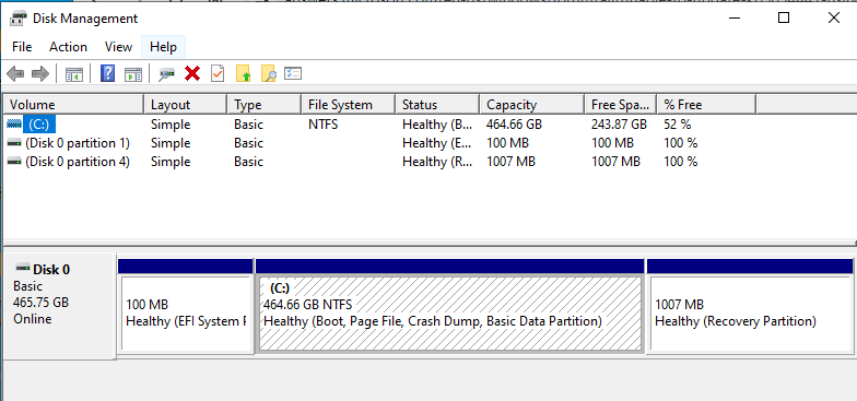

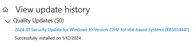

  4. Mark K3 Win User
    KB5034441
    Unable to update (KB5034441) using below links
    SOLVED!
    KB5034441 successfully installed.
    I used some steps here: KB5028997: Instructions to manually resize your partition to install the WinRE update
    Summary of my steps:
    Steps 1 to 3:
    reagentc /info
    Note: partition 4
    reagentc /disable
    Run gparted, adjust partitions.
    Reboot.
    Note - I had to increase the size to 1000MB for this to work, not 750MB.
    KB5034441 ekFwXUGPxEN5rkvGXzz0vIXfo4dhjhMAuAZ4SdQmHJKi%2BkUyvcfizX16hdYtM%2FPjvOZbGdd4IINi17XtLzcjmIgeU%3D.png
    Open CMD as Administrator:
    diskpart
    list disk
    select disk 0
    list part
    sel part 4
    DISKPART> list part
    Partition ### Type Size Offset
    Partition 1 System 100 MB 1024 KB
    Partition 2 Reserved 16 MB 101 MB
    Partition 3 Primary 464 GB 117 MB
    Partition 4 Recovery 1007 MB 464 GB
    Note: skip the 'shrink' command.
    delete partition override [must delete partition]
    Continue entering the commands in diskpart:
    create partition primary id=de94bba4-06d1-4d40-a16a-bfd50179d6ac
    gpt attributes =0x8000000000000001
    format quick fs=ntfs label=”Windows RE tools”
    list vol
    exit [diskpart]
    reagentc /enable
    reagentc /info
    Restart Windows 10
    Install KB5034441.
    KB5034441 B%2FUmCoSrDodb%2FDuXXEGJSjewb35rLzEqBtRiiE8nTFAT0o9TGaJiB7wv5kLcXAqTD%2B4f3Y4c6bzVF82ucjEm2p8%3D.png
    Mark K3, Jan 13, 2024
