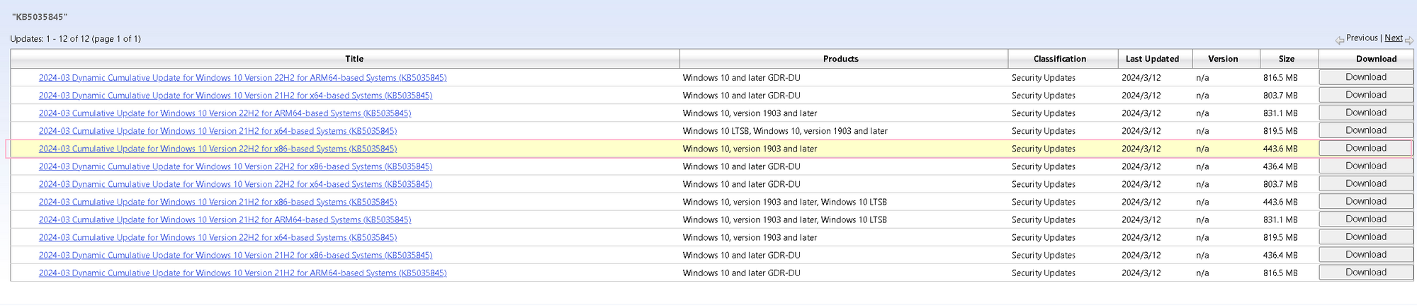

    1. Check Disk Space: Ensure that you have enough disk space on your system drive. The error code 0x800f0922 can sometimes indicate that there isn't enough space in the system reserved partition.
    2. Manually Install the Update: Download the update package from the Microsoft Update Catalog and try to install it manually.

  3. KB5035845 Fails to Install on Win10
    There is no mention of KB5035845 in the log. This is probably because you faced this issue on March 31, 2024, but the log starts from 2024-04-01 08:57:14. i.e., old entries are flushed out. If you find the archived logs in the CBS folder, attach them.
    Or, retry the KB5035845 update and let it fail. Share fresh CBS logs.

    Before that you can try to download the offline package try to install it.
    I also recommend using an ISO for an in-place upgrade to fix the issue.
