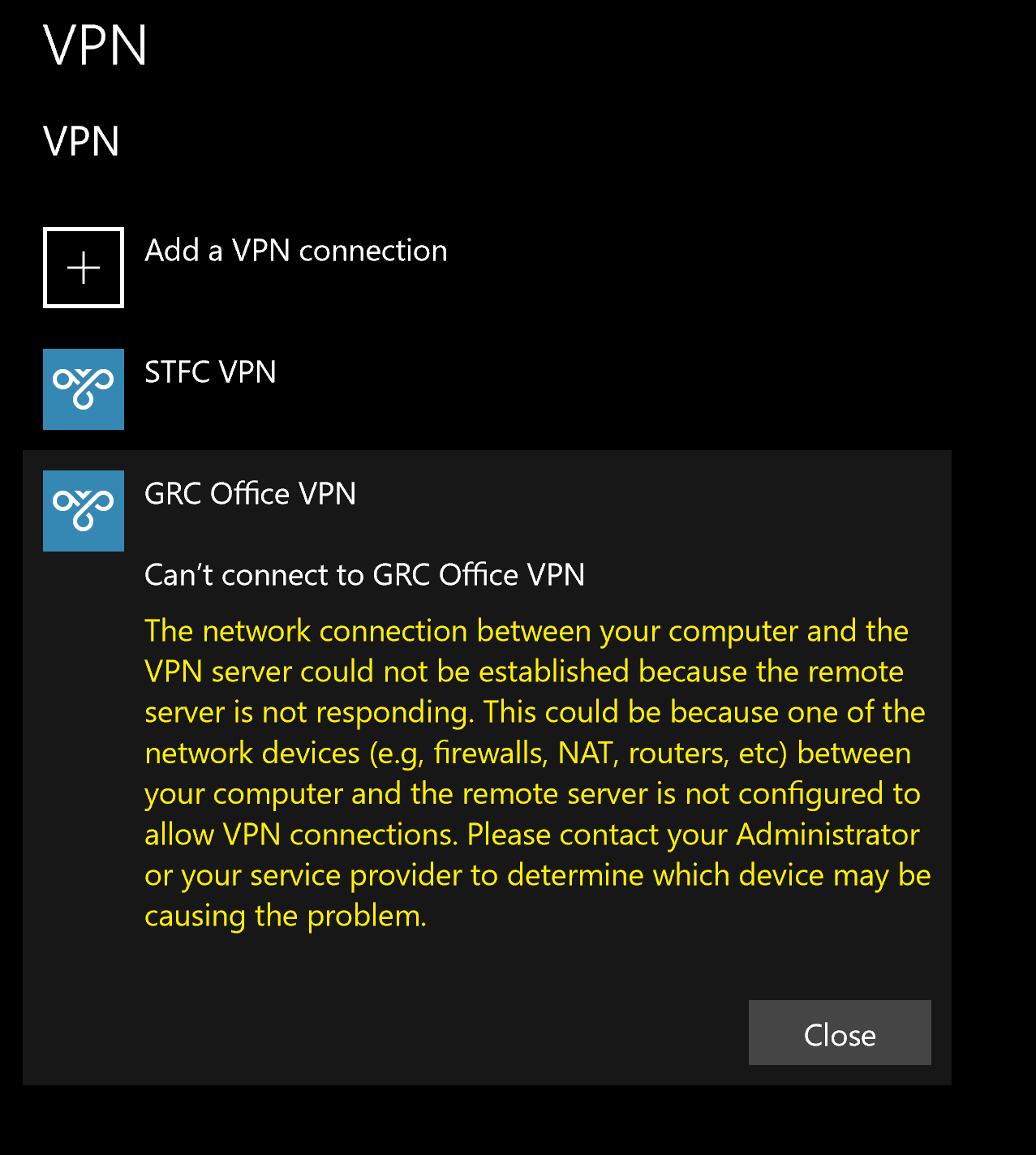

    L2PT/IPSec VPN connection fails when using Wi-Fi
    Connecting to an L2PT/IPSec VPN connection fails when using a Windows 10 computer connected to the network by Wi-Fi. The error obtained is the following:
    L2PT VPN connection restricts internet connection 3425cf65-aa46-47b8-853b-27acbd9f3b9d?upload=true.png
    I am sure the VPN settings are correct because I can connect to the VPN with the same computer, when the computer is connected to the network by Ethernet. Moreover, I am positive there is not a firewall in the way either, because I tested with another computer
    using Ubuntu Linux, and I was able to connect to the VPN over Wi-Fi and Ethernet. Here is a list of the tests I ran:
    • Connection to VPN is sucessfull on Windows 10 when using Ethernet and Windows Firewall on.
    • Connection to VPN fails on Windows 10 when using Wi-Fi and Windows Firewall on or off.
    • Connection to VPN fails on Windows 10 when using both Wi-Fi and Ethernet network connections.
    • Connection to VPN is sucessfull on Ubuntu Linux when using Ethernet or Wi-Fi and UFW firewall on or off.
    All test were run with the computers connected to a TP-Link SR20 router as the DHCP server and gateway. The router has the L2PT and IPSec pasthrough settings enabled. The antivirus used in the Windows 10 computer is Avira (free edition).
    What is preventing the VPN connection when using a Wi-Fi network connection on Windows 10?
    Thanks

  4. JVaso Win User
    Marvelos Reg,
    I will contact my ISP (Spectrum Charter) about it, but can you explain why is this necessary?
    The VPN connection works when the computer is connected to my local network using an Ethernet cable as the access point. However, it does not work when I use a Wi-Fi access point to connect to the same network (regardless of the band, I tried over 2.4 and
    5GHz). Moreover, other computers using a different OS (Ubuntu) can connect to the VPN from the same network (my local network) using both Ethernet and Wi-Fi access points. If there was something in the network (local network or my ISP's network) blocking L2PT/IPSec
    connections or a NAT interfering with the packet routing, I would not be able to connect to the VPN from my local network using an Ethernet access point or another computer. However, I am able to do that, which shows my ISP does not interfere with VPN traffic.
    That is my understanding, but I am not a networking engineer, so correct me if I am wrong.
    JVaso, Jun 9, 2023
