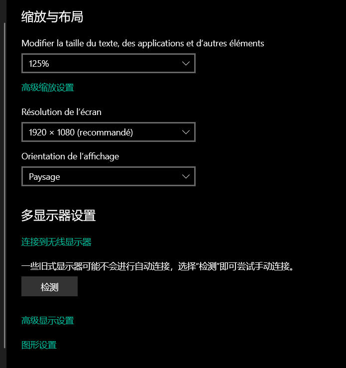

    The problem exists when:
    Step 1. The original language (both display and input) is Chinese (China).
    Step 2. Change the display language (but not the input language) to French (France), log in again, and then problem arises: Some part of the UI is French and some part of the UI is Chinese.
    Language discrepancies input and display language d5f2e8fd-6e39-4995-b33f-983ae47c787f?upload=true.png

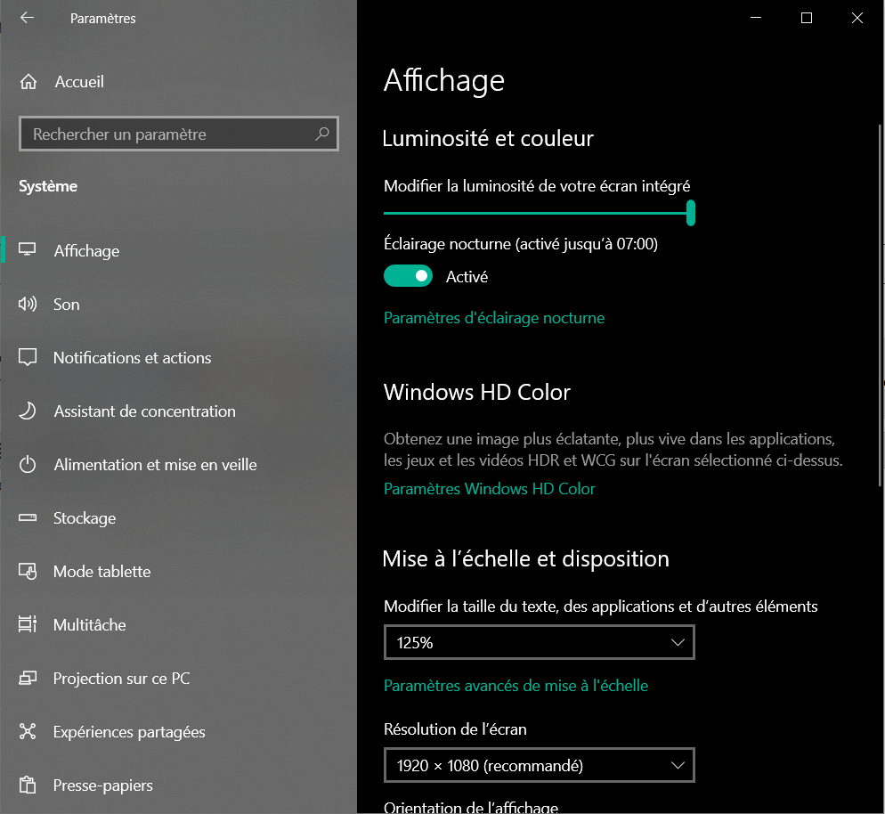

    However, the problem can be magically solved, when:
    Step 1. Change the input language to French.
    Step 2. Reopen the faulty app (here it is Settings, but the same problem arises in other system apps as well), and then problem disappears.
    Language discrepancies input and display language 2f22faa2-8f42-4dc9-a248-5a4e00274518?upload=true.png
    Theoretically and logically, the choice of the display language should and should only affect display, while the input language should have nothing to do with display. But from this we can see these two settings are not working as expected.
    What's more, the "language mix" does not appear again when you change the input language BACK to Chinese.
    That is to say, the problem only appears when the input language first differ from the display language, and part of the language display wrongly correspond to the preferred input language, which can be solved when the two settings become the same, and the
    problem do not appear again when input language is changed once more.
