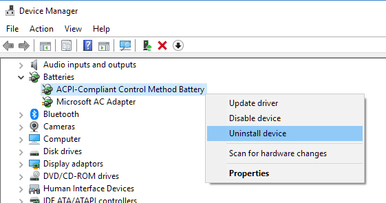

    Recently, my laptop battery stopped working, and ever since, I've noticed that sometimes when I boot up my laptop, the CPU clock is significantly lower than normal, my CPU base is 3.0 GHz and it lowers down to 0.2 GHz! Making the laptop almost unusable and booting it is really slow. Interestingly, as soon as I open ThrottleStop, the CPU speed returns to normal and stays stable afterward. I think it has something to do with the "BD Prochot" Settings, I untick it and it goes fine, though my laptop wasn't overheating when that happens.This issue seems to happen especially when I don't shut down m

    Another thing you could usefully look at is Device Manager. You should find 'ACPI-Compliant Control Method Battery' under Batteries. Try uninstalling it then let Windows scan for new hardware and reinstall it.
    Laptop CPU throttle after battery failure 193157d1529674775t-laptop-startup-battery-failure-device-manager-batteries.png
