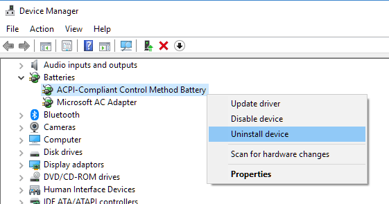

    Another thing you could usefully look at is Device Manager. You should find 'ACPI-Compliant Control Method Battery' under Batteries. Try uninstalling it then let Windows scan for new hardware and reinstall it.
    Laptop CPU throttle after battery failure 193157d1529674775t-laptop-startup-battery-failure-device-manager-batteries.png
