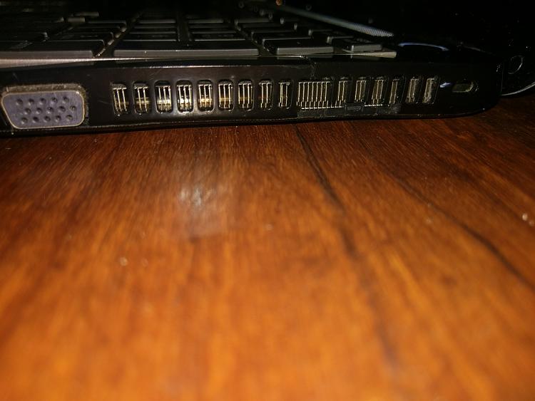

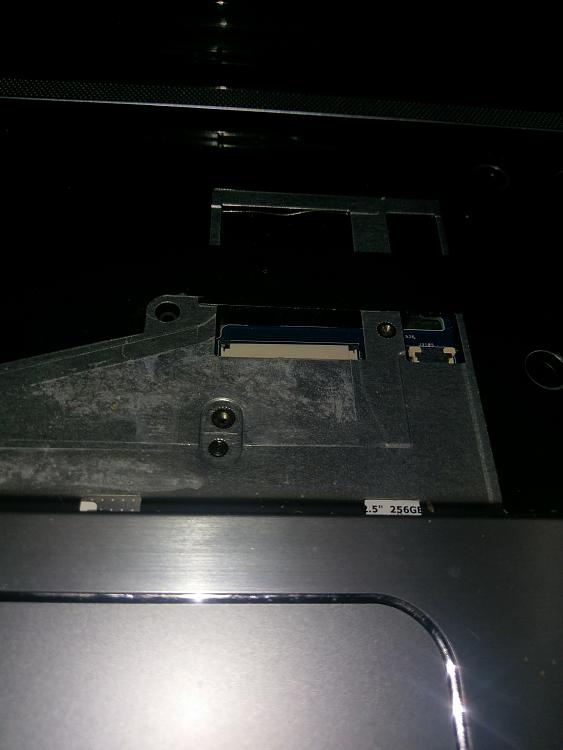

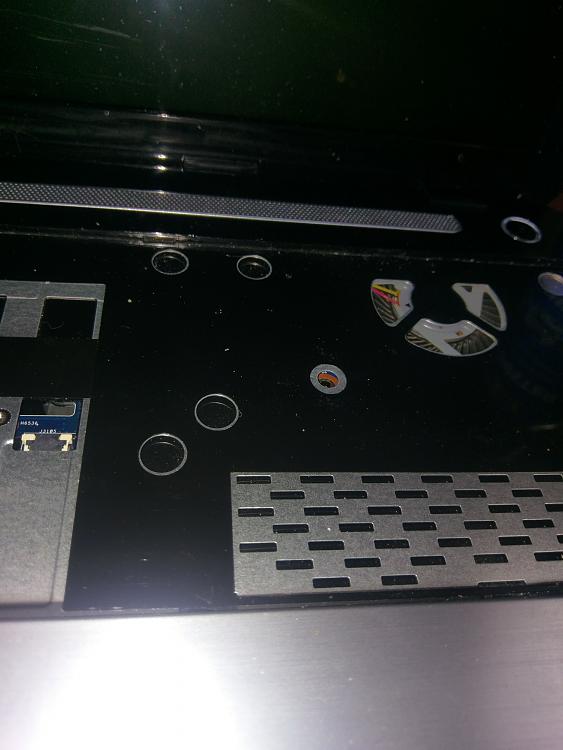

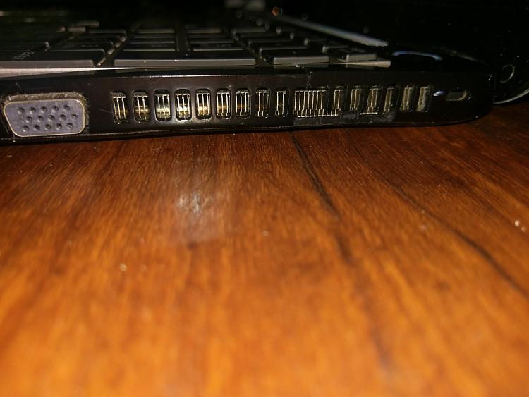

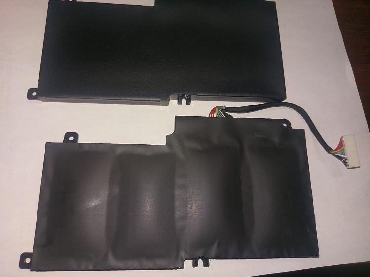

    Try again with the pictures... I also included other pictures of the damage the heat has done to the plastic chassis of the laptop. Over the years the heat has become so extreme that bits of plastic around the exhaust grill has melted or chipped off. Also, you can see how the underside of the keyboard takes the brunt of the heat from the CPU fan and battery which sits just underneath the keyboard wires (in fact just a bit of tape separates the keyboard flat cable and the swollen battery.

    I'm starting to think the bios or the regulator that gives power to the keyboard is faulty on the mainboard. Those two issues are expensive fixes though.
