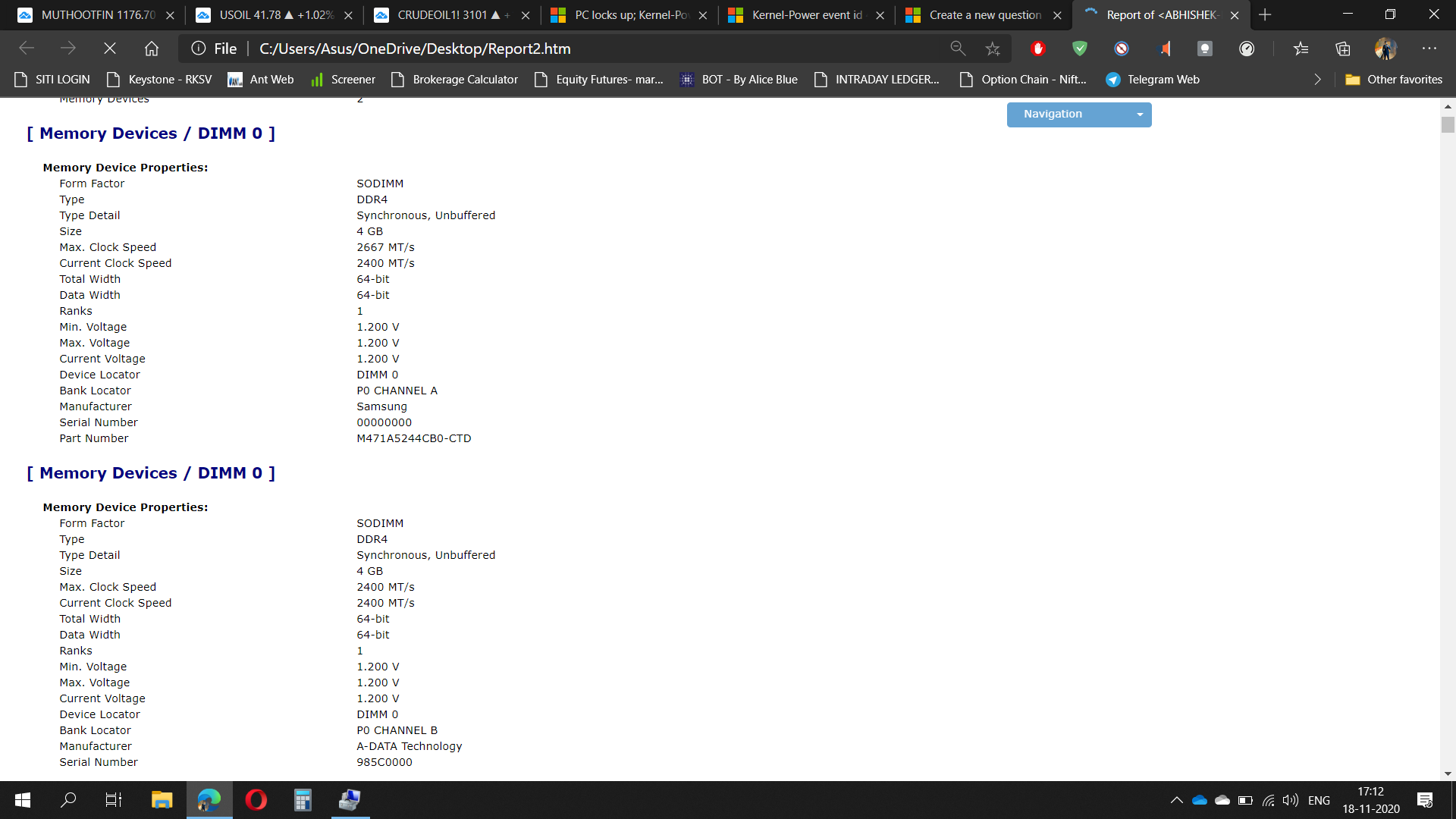

    Hey, I have recently upgraded ram on my laptop and i'm facing frequent restart after that up looking the event logs i came to know about the kernal power issue, i have tried all the methods available online and even got the ram replaced with the company but the error is still their.
    I have attach the details of the ram please help if anyone can!!! Laptop Restart, Kernel-Power Event ID 41, Task 63 e3d77984-f10a-44ee-916d-8e27ff438a0b?upload=true.png

    You mean you are getting Attempted switch from DPC. Kernel-Power. Event ID 41. Task 63 again?
    If so, are you getting a dump. If yes, run DM_Log_collector again and upload the zip file.
