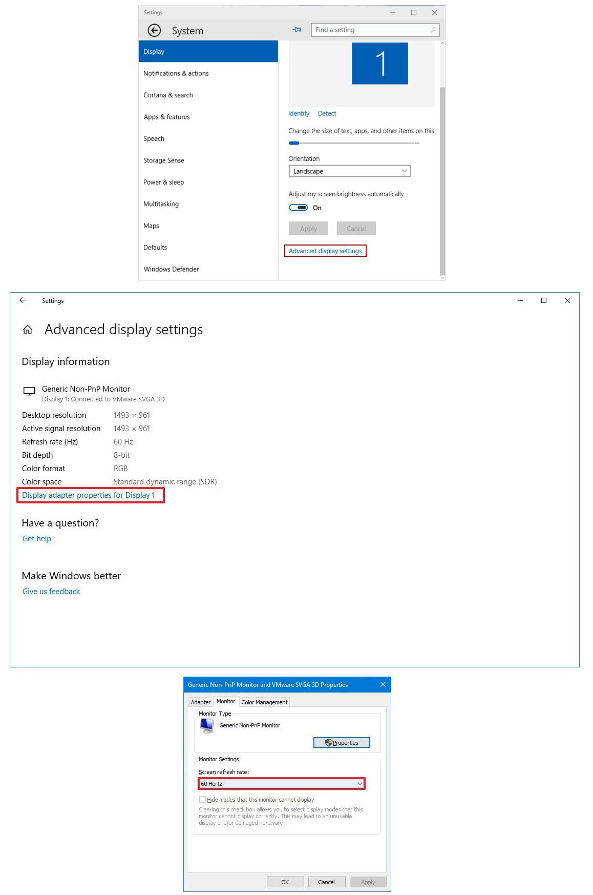

    To check what refresh rates are now applied to your monitors, you can go to Windows Settings and then you go to System/Display and there at the bottom of the windows , you will see "Advanced Display Settings". In the example given in the picture, yo see there
    is only one monitor, but if you have 2 there will be a drop-down list where you can select the one monitor displaying 1920*1080. Then you can click on "Display Adapters setting for display" and another windows will open. Go directly to the monitor tab and
    there you will see a drop-down listing whatever refresh rates are available for that monitor. If it's displaying 120hz, lower that value to 60hz, and go back to display to see if you change the resolution to 2560*1440.
