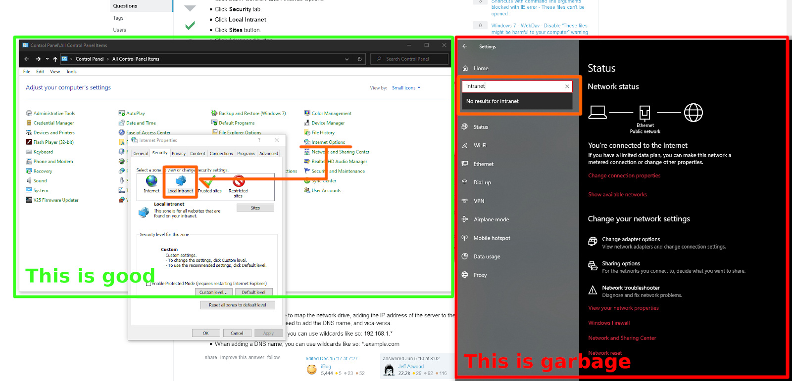

  1. Local network / smb shares and notifications
    Why is the issue with local share security warnings still a problem? I shouldnot have to click OK in this box every time I touch a file in thesame shared directory. Why, ten years later, is there stillno simple, straightforward way to turn this notification off? without disabling security notifications in bulk Why is Windowsstill not competent enough to know the difference between a local file share and the Internet? Why is the Control Panel being deprecated while Settings does not yet surface all of the necessary configuration options?
    Seriously Microsoft, get your networking together.
    Local network / smb shares and notifications e597e599-e587-4bc6-939d-26bd1842dcf3?upload=true.jpg
    To quote the answer given a decade ago:
    "This worked for me, but it's a bummer I have to manually enter IPs here.. it would be nice if Windows could detect this is a local network file copy and skip the irritating and pointless warning about 'dangerous' files."
    recursiveloop, Apr 9, 2020
