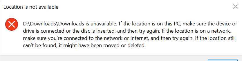

Discus and support Location is not available. Downloads is unavailble. If the location is in this PC............ in Windows 10 Network and Sharing to solve the problem; Send help please. [ATTACH]... Discussion in 'Windows 10 Network and Sharing' started by Hishirozsan, Apr 1, 2021.
  1. Location is not available. Downloads is unavailble. If the location is in this PC............
    Send help please. Location is not available. Downloads is unavailble. If the location is in this PC............ 9f4a03a7-c445-40e9-9ac7-27713aee2958?upload=true.png

  4. Location is not available. Downloads is unavailble. If the location is in this PC............
    Quick Access - "Location is not available"
    I can’t seem to delete an unpinned folder that is listed in Quick Access in the navigation pane..
    A dialogue box comes up telling me that it is not in the location that it is supposed to be in.
    I have looked at the suggestions here, but they all deal with a PINNED folder on Quick Access.
    I’ve tried them all, but none of them work. In my case, the folder that can’t be located is an UNPINNED folder.
    I know that these unpinned folders are ones that are frequently accessed and they disappear after a while when they are no longer frequent.
    But, this unpinned folder is never going to disappear, because it will never be located.
    I think I know how this happened. The folder in question is the SYSTEM Downloads folder.
    1. Somehow, this SYSTEM Downloads folder was moved to C:\Users\personalfoldername\Searches, so its path became C:\Users\personalfoldername\Searches\Downloads.
    But, a DELL agent who was trying to help me sort things out, deleted this SYSTEM Downloads folder.
    I discovered this when I clicked on the Downloads icon to the very left of the Start Menu, because a dialogue box came up that told me that c:\Users\personalfoldername\Searches\Downloads could not be found.
