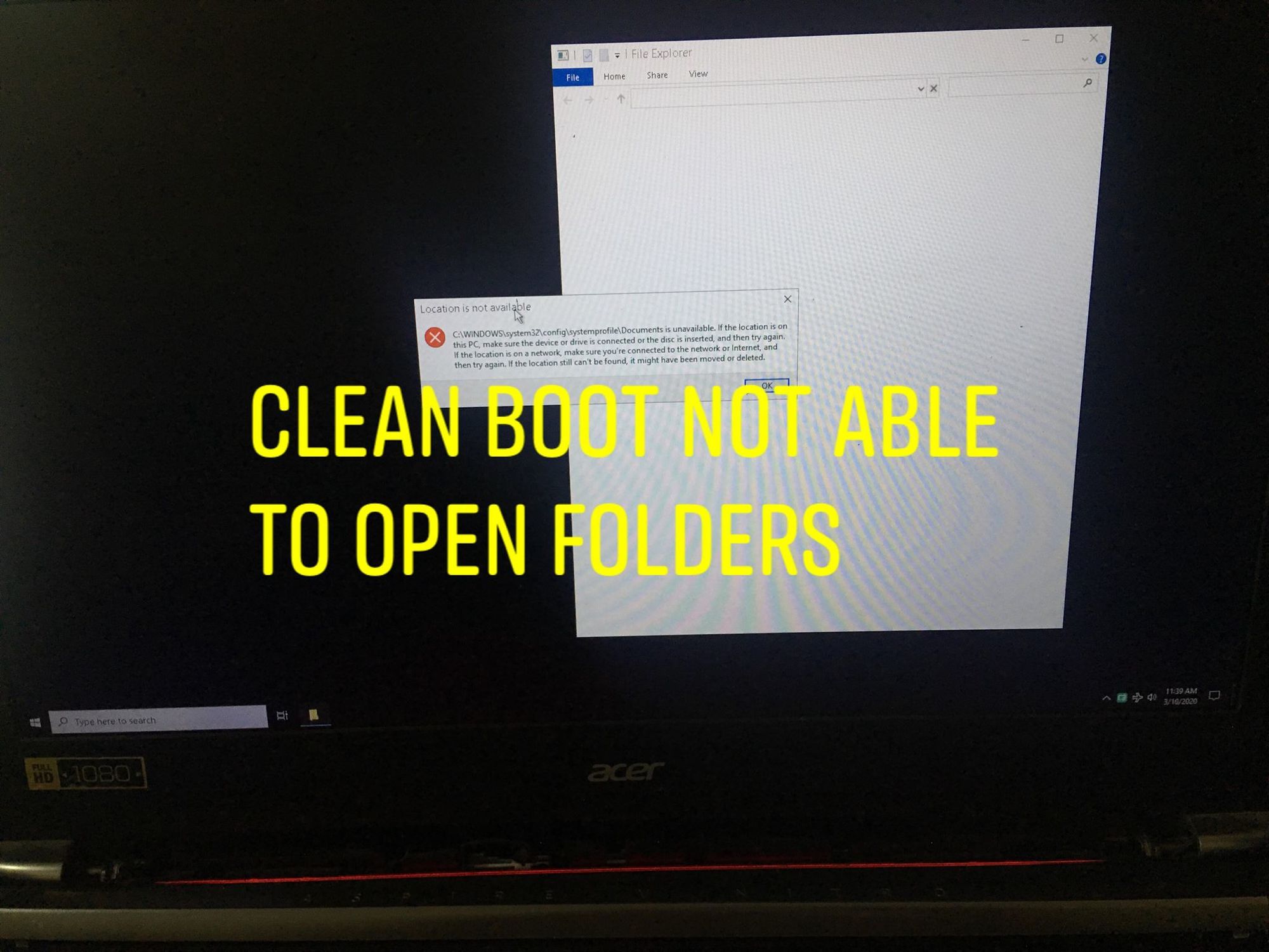

    After Login, Black Screen, can see and use mouse, no taskbar, no desktop icons, you can see the Recycle Bin icon after closing the popup saying your desktop location is not available, Ctrl Alt Del works.

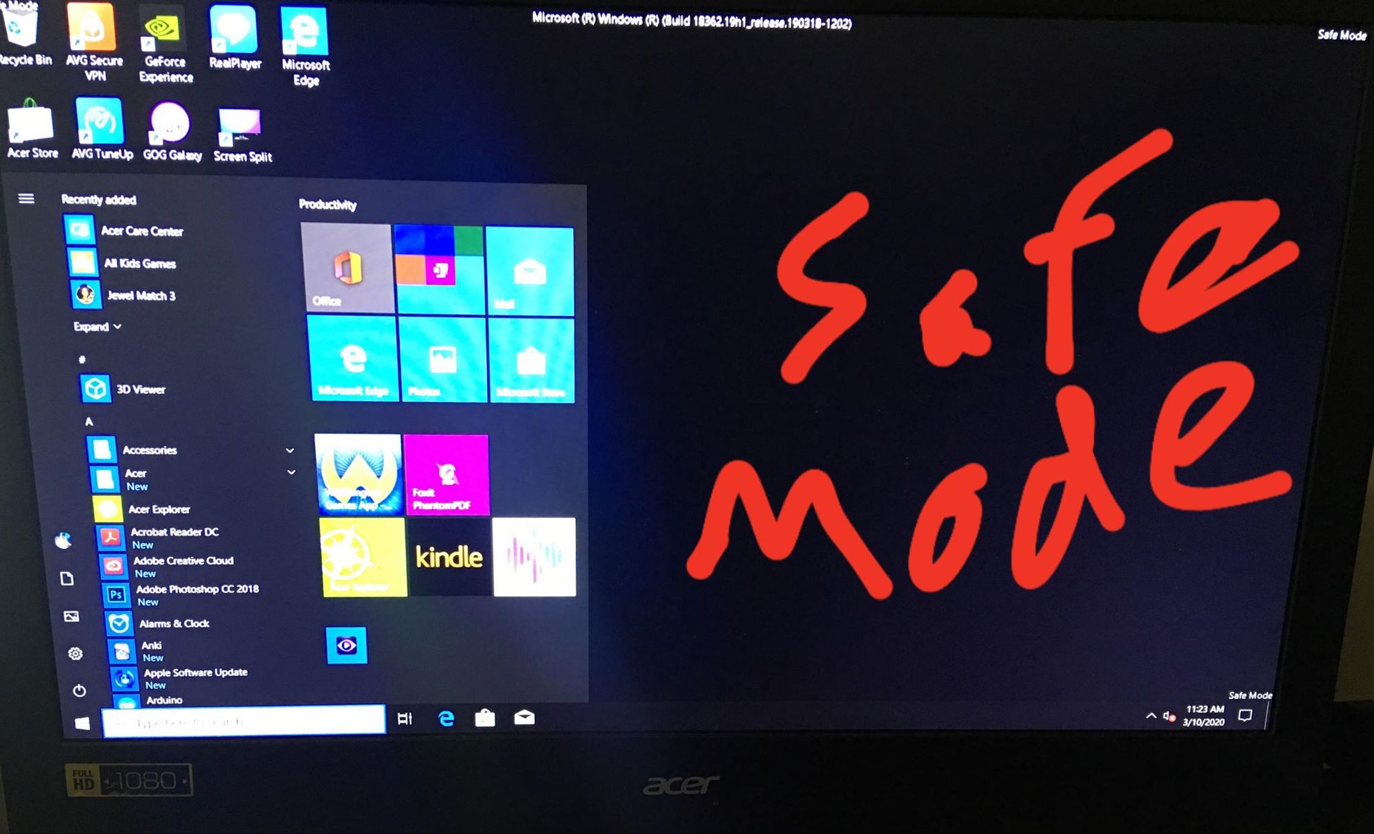

    Safe Mode works, I can see my desktop icons and the taskbar.

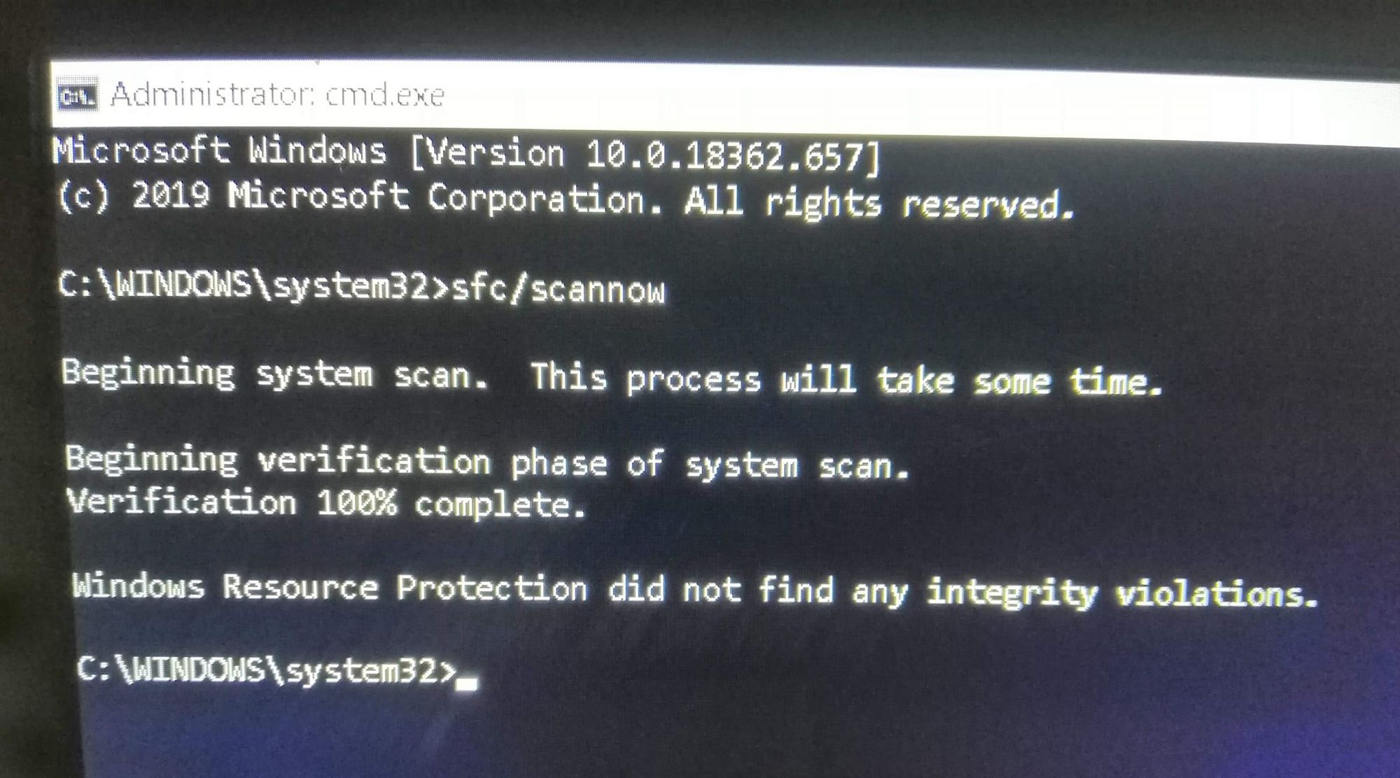

    I ran the SFC: Scanning OS
    Command Prompt: sfc/scannow
    Windows Resource Protection did not find any integrity violations.

    Alt Tab Del brings up Task Manager, able to open folders from here, when opening folders popup location not available.

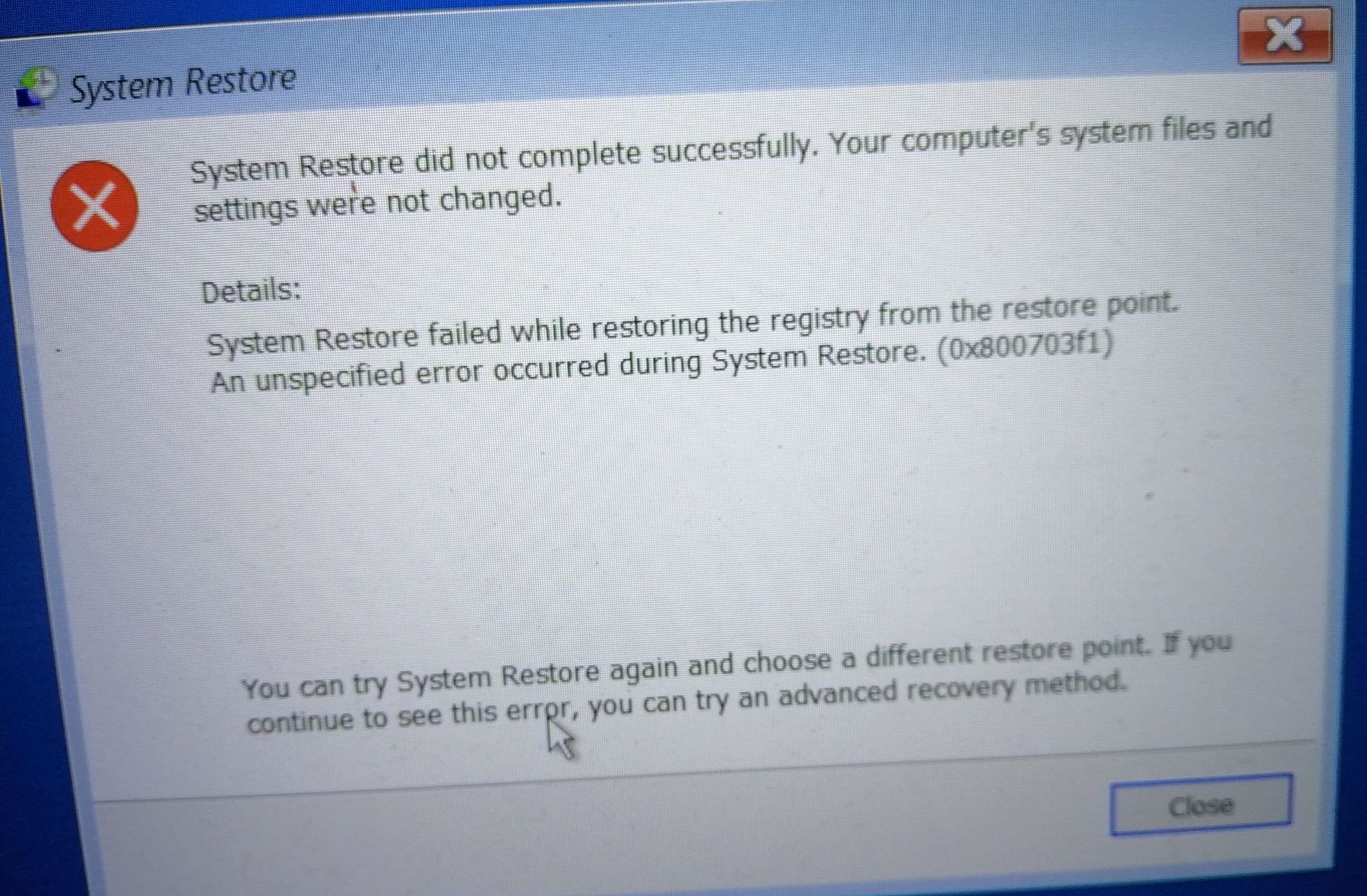

    Did System Restore previous version, from last backup, had two different ones, did both:
    System Restore did not complete successfully. Your computer's system files and settings were not changed.
    Details: System Restore failed while restoring the registry from the restore point. An unspecified error occured during System Restore 0x800703f1

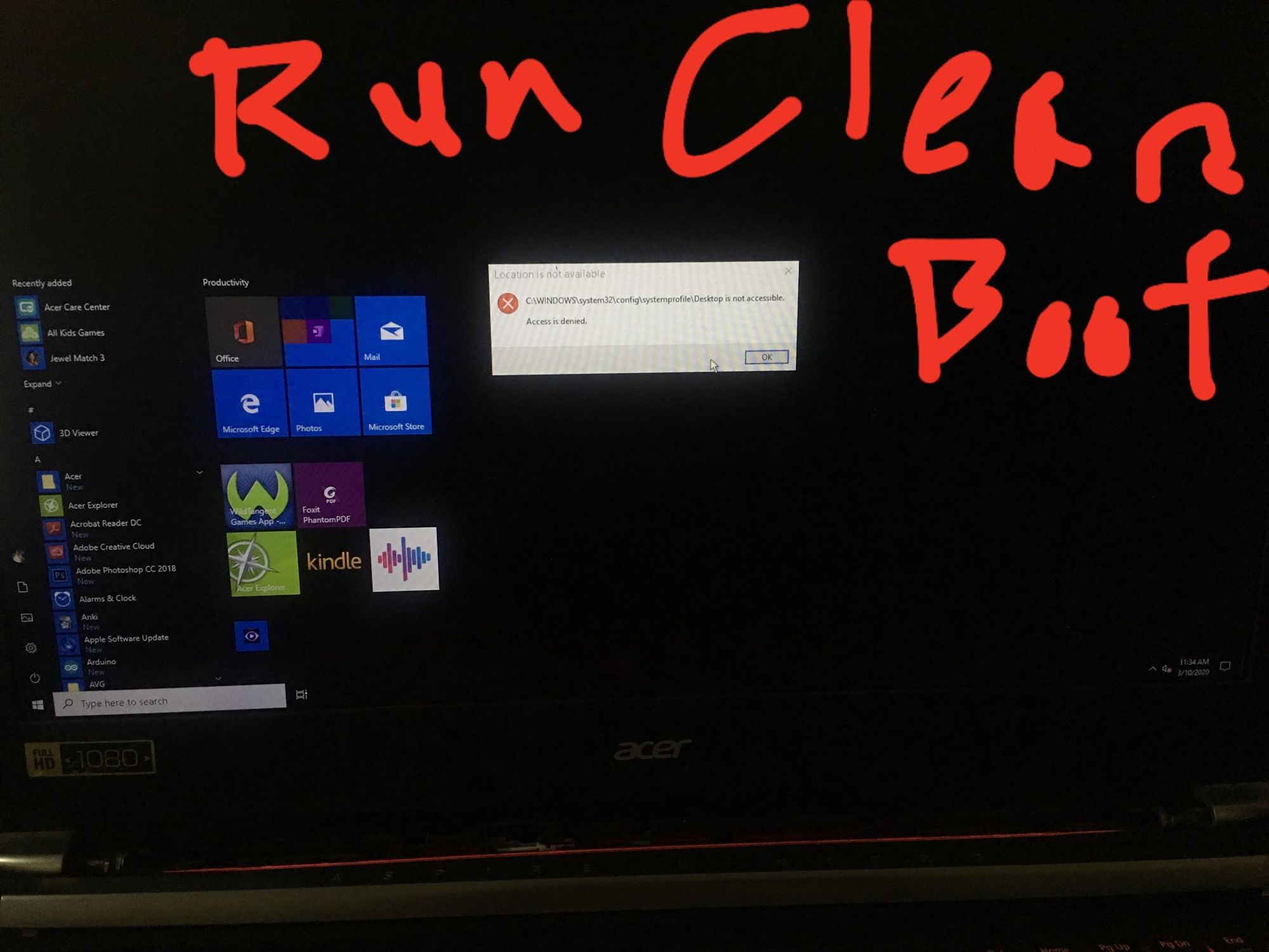

    Run Clean Boot Had to do it in Safe Mode, can't open it in normal mode:
    Reboot Safe Mode: SAFE MODE WORKS, I can see desktop icons, and taskbar
    Trying to open Doc/Pic/Vid results in "Location is not available".
    Click Windows Start, type msconfig.exe in search box.
    Click Msconfig
    At General tab, UNCHECK the Load Startup Items from Selective Startup button
    At Service tab, check Hide All Microsoft Services, then click Disable All
    Restart computer
    Results: Can see taskbar and use, Desktop black no icons, popup saying the Desktop Location is not available
    Can not open doc/pic/vid, popup saying Location is not available.
    After closing the popup about the Desktop not available, I can see only one desktop icon, the Recycle Bin.

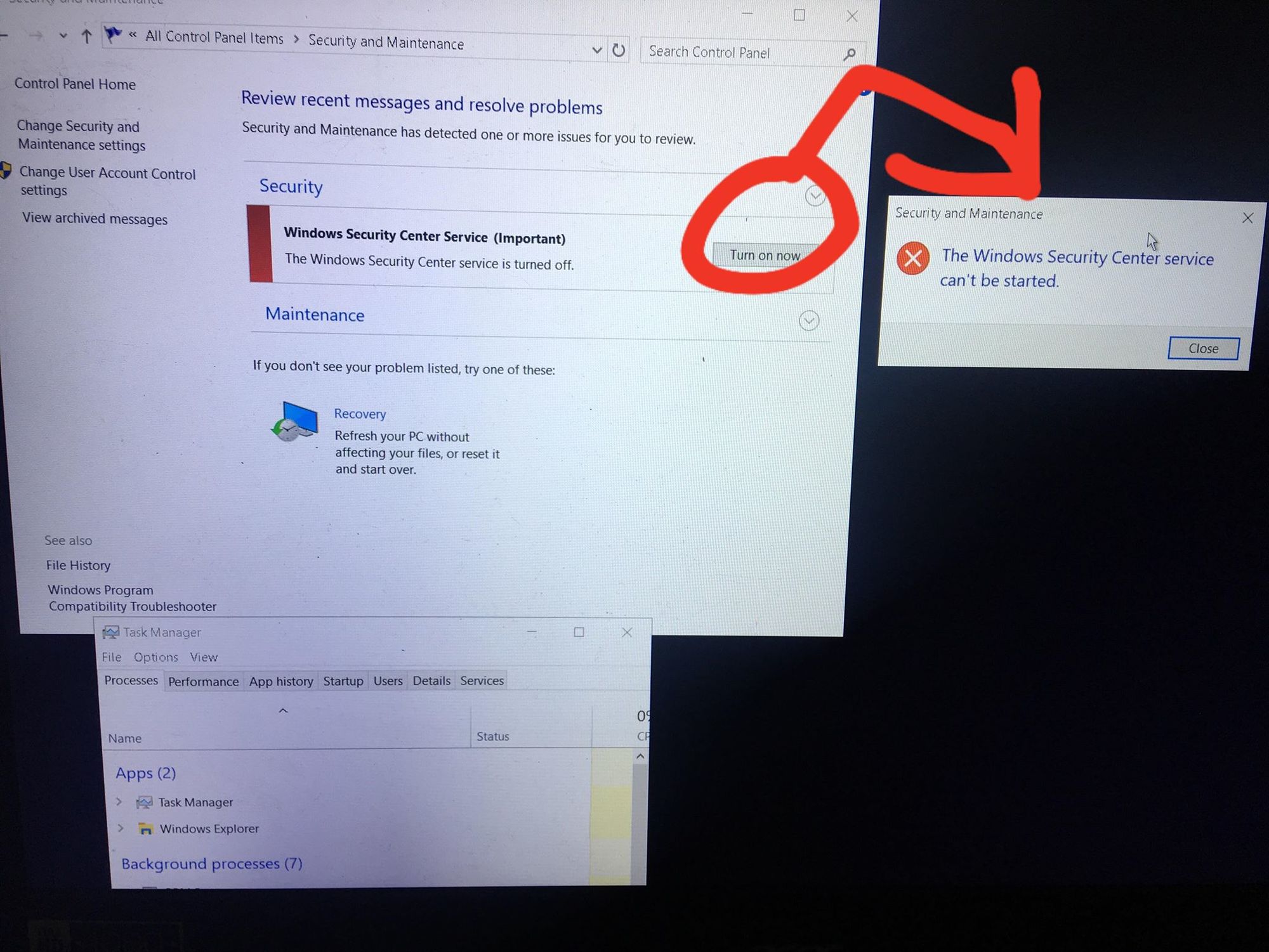

    Windows Security Center Service Important The Windows Security Center service is turned off. Clicked button to right "Turn on now"
    Pop up, The windows security center service can't be started.

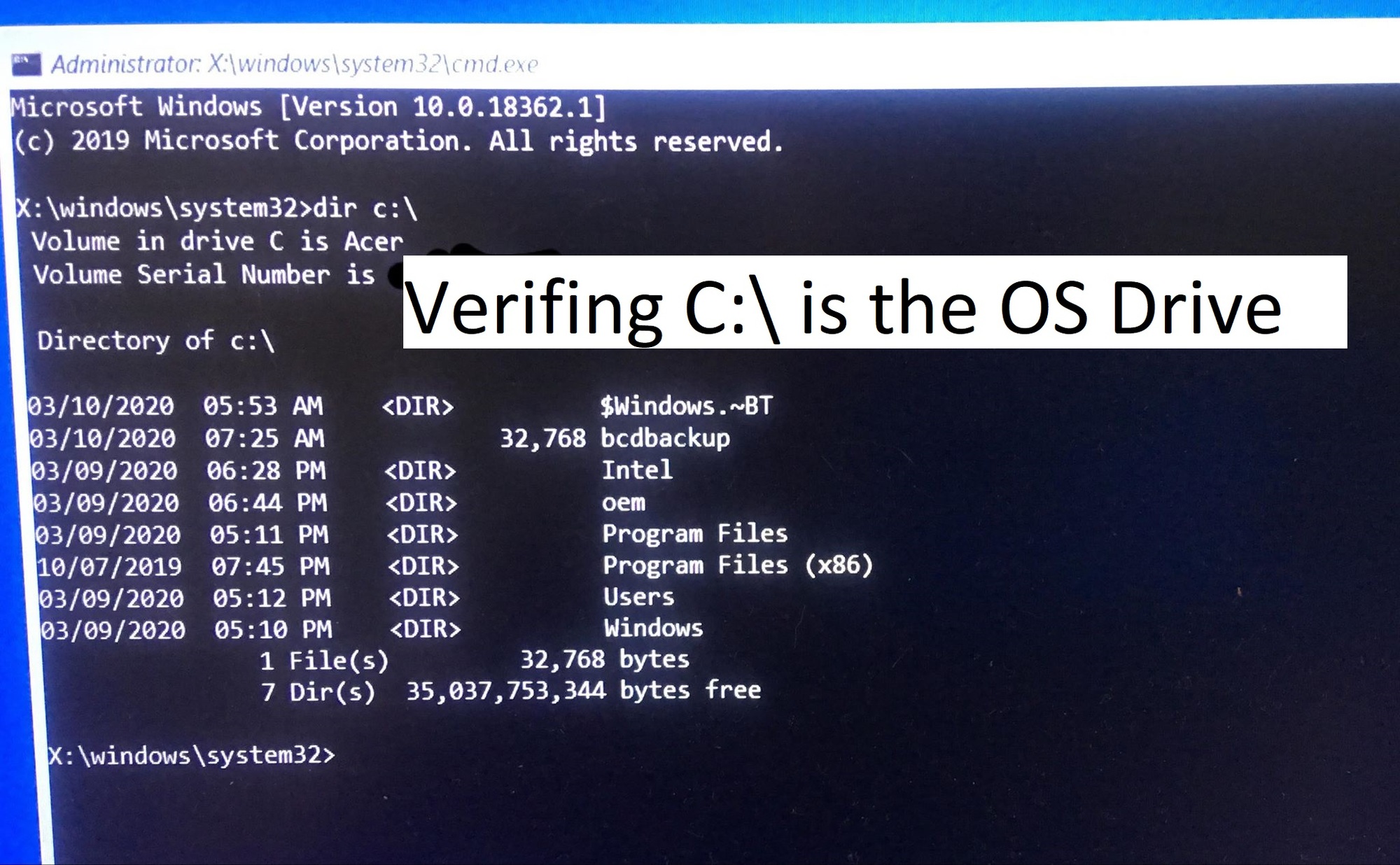

    Command Prompt:
    bootrec /fixmbr
    bootrec /fixboot
    bcdedit /export c:\bcdbackup
    attrib c:\boot\bcd -h -r -s //It says it can not find boot...? The OS is verified on this C:\ drive
    ren c:\boot\bcd bcd.old
    bootrec /rebuildbcd
    y
    exit
