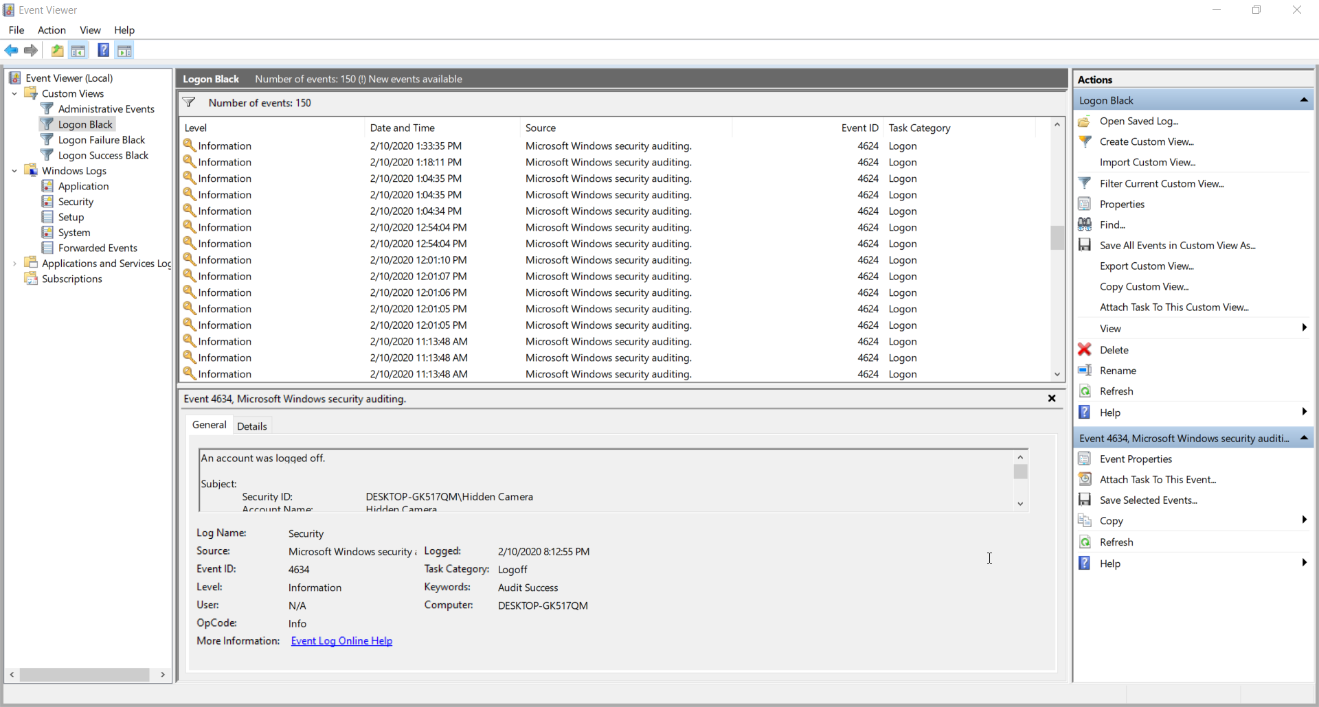

  4. Logon Event Event ID 4648. Events only log during a successful remote desktop in to the...
    Logon Event IDs Explanations
    I'm a non-dev person and would like some answers regarding Event Viewer in Windows 10. I wanted to keep tabs on if my PC was logged in during my absence. I found that Event ID 4624 shows the successful logins. But when I filter the ID, it turns out that
    several events are being logged and there's no way to find out which time actually a human logged in. My questions are:
    1. My Event viewer for 4624 filter looks like this: https://sc.vtedev.com/hafiz/02_10_2020_0000.png . Is this normal?
    2. If yes, how can I separate the actual human logins from these automated logs?
    3. If no, is there a malware that's causing it?
    4. Am I using wrong Event ID? If yes, can you suggest me the correct one?
    I'd really appreciate any help on this. Thanks and great day!
