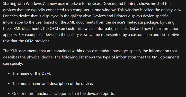

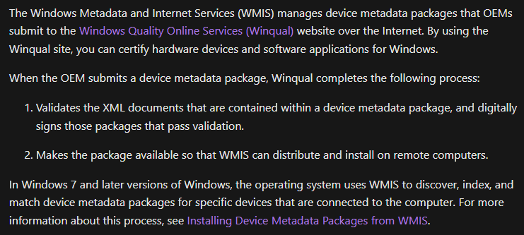

    Event 131 may also be accompanied by information related to "metadata".
    The contents in this link described some information related to device metadata.
    Based on information in some of the threads containing similar issues, the logging of this type of event may be relevant to the driver's update event.

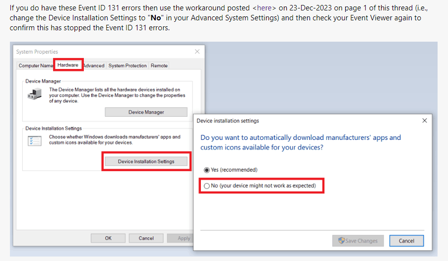

    Some community members have suggested adjusting the "Device Installation Settings" as a way to temporarily block Event 131 logging.
