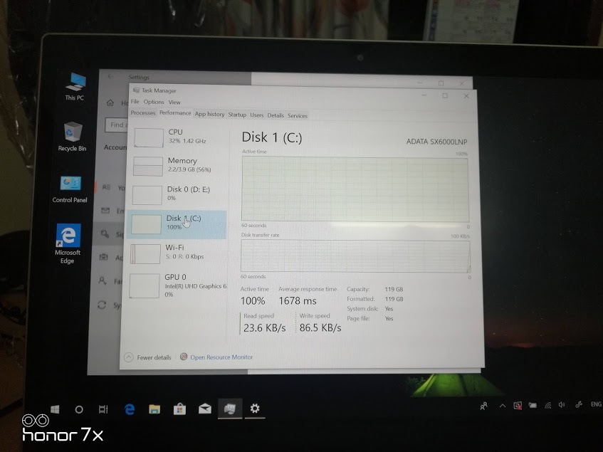

  1. Low Ram Causes SSD use 100% and Windows 10 freezes ?
    My laptop Confirmation is 4 gb ram and 128 ssd . I am facing SSD 100% Usages issue and due to windows freezing Issue .
    is it problem causes due to low ram Low Ram Causes SSD use 100% and Windows 10 freezes ? e98d8ff2-2364-4bfe-84e9-6487bf67ff48?upload=true.jpg
