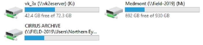

    Net Use doesn't show mapped drives
    Hi guys,
    I have 3 mapped drives which are accessible.
    map net work drive 329653d1619519714t-net-use-doesnt-show-mapped-drives-shared-drives.jpg
    However, when I run net use command I'm getting this output.
    Does anybody know why is it so?
    Pinocchio21, Oct 30, 2023
