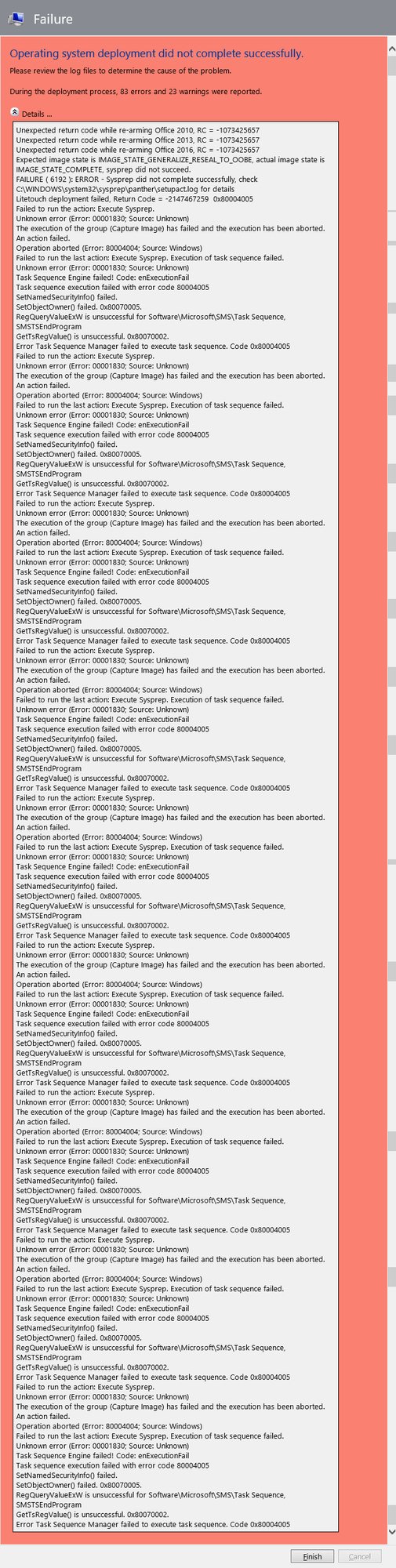

  3. Windows 10: MDT Sysprep and Capture Task Sequence Failure.
    Sysprep and Capture task sequence fails when it tries to capture Windows 10 Professional.
    OS: Windows Server 2008 Enterprise 64bit
    MDT (6.3.8450.1000)
    Windows Assessment and Deployment Kit - Windows 10
    Windows Automated Installation Kit
    MDT: Capture and sysprepped reference image 582a745d-82ec-472e-be37-7829322aa862?upload=true.jpg
    EricLoh_96, Jul 4, 2018
