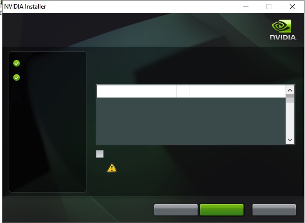

  2. Blank nvidia installshield wizard?
    I'm trying to install new driver but why does it blank? The uninstall wizard blank too, I have no idea why this is happening, anyone have a clue? It looks like this, I have tried several driver but it still the same.
    Apocalypsee, Nov 23, 2020
