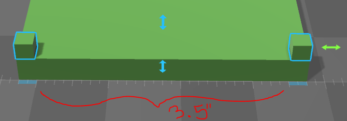

    Currently in the app the tools for measuring are 1) the numbers representing of the dimension of the object(s) and 2) the build platform (the checkered grid that represents the ground/floor) x and y axis rulers.

    Next I created the squares you described above. I selected the two squares you are trying to measure the distance between and put them up against one of the rulers on the build platform. From there I can get a rough idea of the distance between the two objects:
    Notice that the selected objects are also highlighted on the ruler on the build plate and because the units selected are in inches the marks on the ruler are also in inches. Using it we can see that the ruler marks add up to 3.5 inches.
