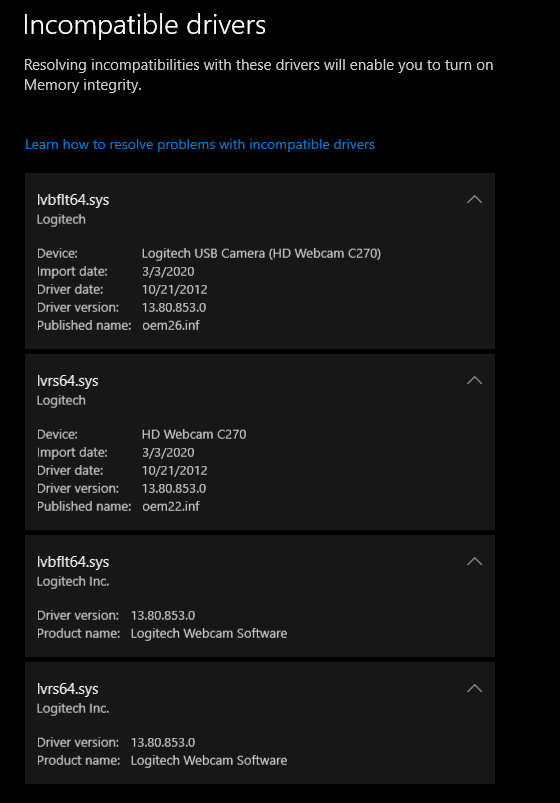

    Memory integrity blocked by windows 10 drivers
    I tried to turn on the memory integrity option and it said that lvbflt64.sys and lvrs64.sys are preventing it from doing so. It said they were from a logitech webcam, I do not have a logitech webcam. I typed "driverquery/v" into an elevated command prompt
    and found out that these were windows 10 drivers that came with my windows install, but it says they're for a logitech webcam I never owned. Why are system drivers blocking a security feature that the system came with, and why is it blaming it on a webcam
    that I never had? It also says that it's blocked by logitech webcam software but that isn't even installed.
    Memory integrity blocked by APG8201ZX64.SYS fixed e9ceaa7e-e836-4c20-bea4-68afd3f67bd4?upload=true.png
    Nyrif, Sep 9, 2022
