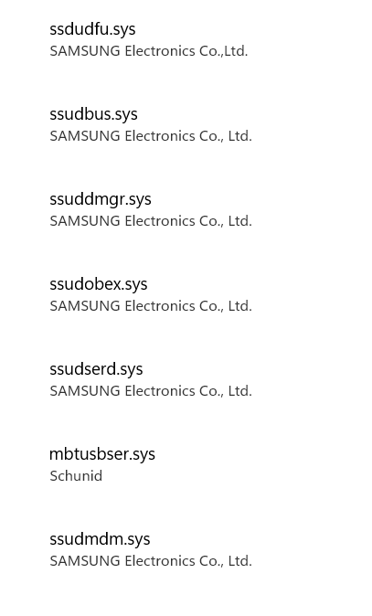

    I had a warning message on my computer, saying "memory integrity can't be activated due to incompatible drivers".
    First, I don't even understand what it means concretely, could you explain?
    Second, I checked and found the attached list of drivers.
    memory integrity can't be activated due to incompatible drivers 424821f0-4b4e-45de-90af-c67a38890d35?upload=true.png
    Lots of them are Samsung's which makes sense as I have a Samsung smartphone. I don't know what the other one is about (mbtusbser.sys).

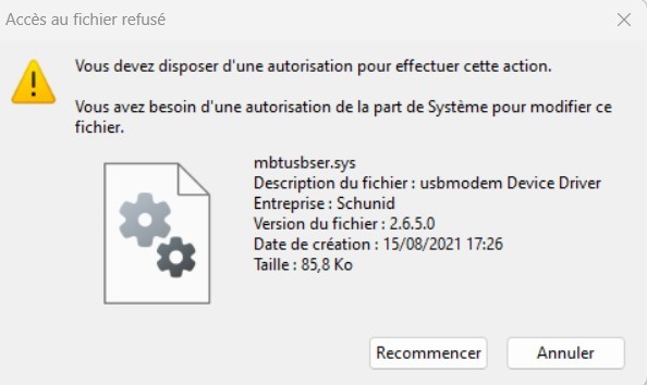

    I followed the instructions given in this thread of discusion (memory integrity can't be activated due to incompatible drivers - Microsoft Community) and tried to rename .old the drivers in question.
    It worked for only one of them (the 2nd: ssudbus.sys). For all the other ones I had a message saying that I needed an authorization from the system.
