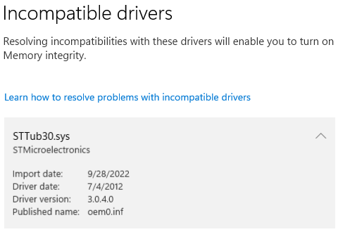

    My attempt to enable the Memory Integrity security feature also failed:

    Note that for my system the problem driver was STTub30.sys which was published via oem0.inf. Your details will probably be different so be careful to target the correct driver when uninstalling. Keep in mind that Microsoft does not recommend removing installed drivers. They do recommend that you update them but in my case I don't know where STTub30.sys came from and STmicroelectronics doesn't have an updated driver that I can find and install.

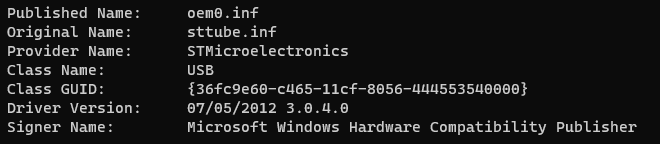

    Command Prompt Attempt Using pnputil:
    Open a command prompt as admin. Locate the provider name and verify the *.inf information matches the detail from the original attempt error message to enable memory integrity.
    pnputil /enum-drivers

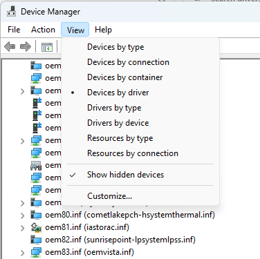

    My pnputil command failed above so I next tried Device Manager (Win-X, Device Manager):
    Memory integrity forced off "incompatible driver" STTub30.sys STmicroelectronics d3359b9d-ef54-4833-ba62-7bd80eb47aef?upload=true.png
    1. From the View menu enable the "Show hidden devices" feature then "Devices by driver."
    2. Right-click on the *.inf corresponding to your issue and select remove.
    3. Reboot
