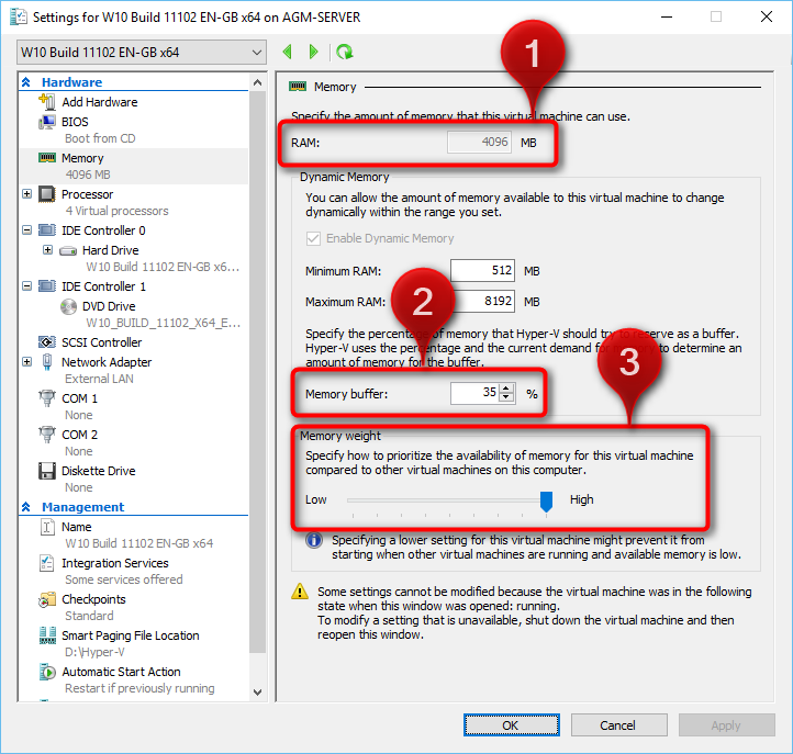

    For the dynamic memory to work you need to assign enough startup memory (#1 in screenshot below), increase the the memory buffer (#2) and memory weight (#3):
    Memory not increasing dynamically in Hyper-V with Windows 10 guest. 60455d1485962311t-windows-10-hyper-v-dynamic-memory-2016_01_24_16_58_091.png

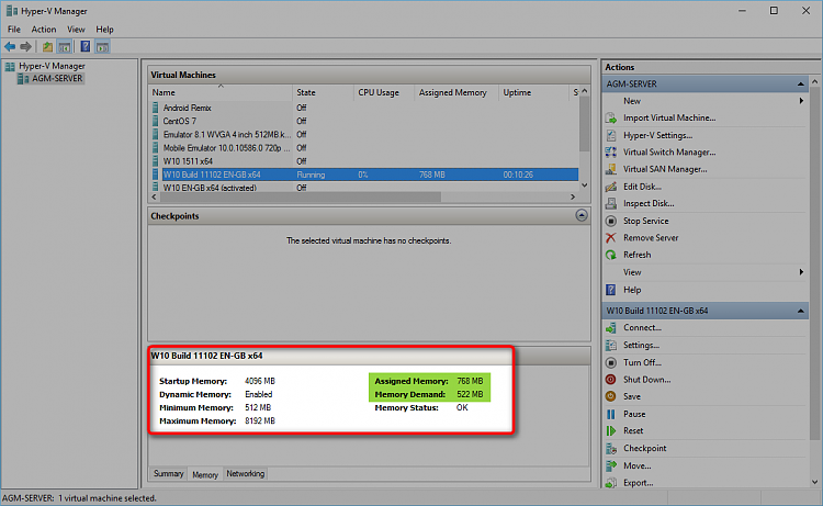

    A Windows 10 virtual machine needs surprisingly little RAM to function well. Here in the screenshot the memory usage of a Windows 10 vm otherwise idle at the moment, only running Macrium to create a system image. Memory demand only 522 MB but because I have assigned a 35% buffer, it's using 768 MB of the assigned maximum 8 GB:
    Memory not increasing dynamically in Hyper-V with Windows 10 guest. 60458d1485962311t-windows-10-hyper-v-dynamic-memory-2016_01_24_17_03_572.png
    The buffer is important: When using dynamic memory and the demand suddenly increases for example due a resource heavy application being launched, it takes time for Hyper-V to assign more RAM to the vm. The bigger the buffer, the better the vm reacts to increased demand.
    Dynamic memory should only be used when it really is needed, for instance when it is important to have multiple virtual machines running at the same time. Dynamic memory should not be used when installing Windows, it can make the time needed for installation somewhat longer.
    Generally speaking a Windows 10 vm with 2 GB of static RAM assigned works faster than the same vm with 512 MB to 4 GB dynamic RAM.
