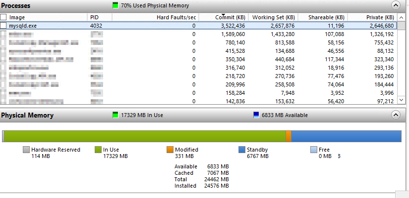

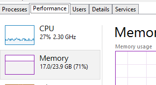

    Trying to troubleshoot memory usage in the VPS.
    The server itesef has 24 GB RAM available, and around 70-90% is constantly being in use.
    The most resource-heavy process we have is MySQL, which is configured to roughly take 3 GB of memory.
    From resource monitor and absolute value I can see, that it's using 2.6 GB at the moment. however if I switch value to %, it becomes 30%
    I would like to know, how does Task manager calculates this percentage value, and whether there is any possible issue in displaying the results.
    Please check the screenshots below for some visual aid.
