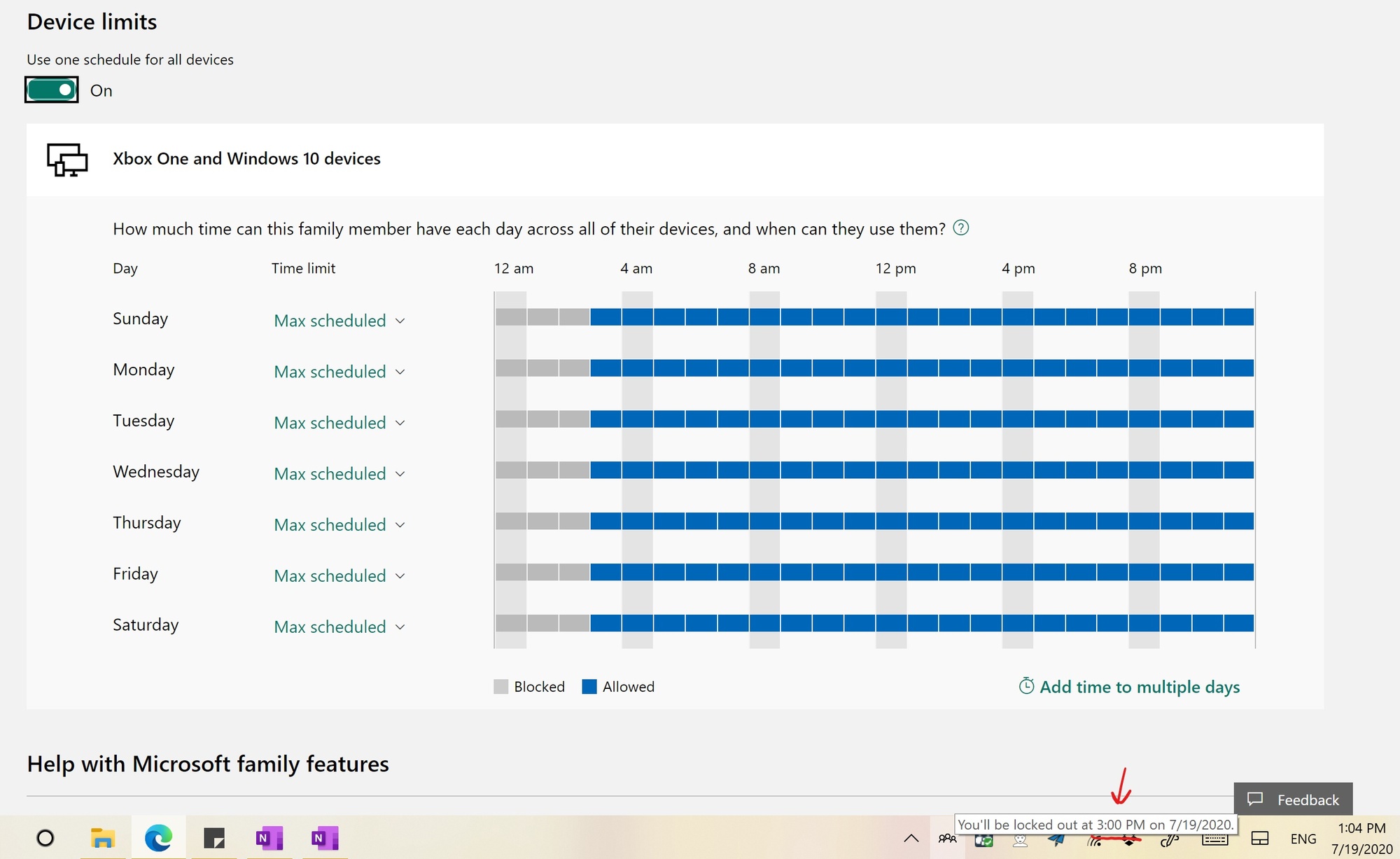

    As seen in the screenshot, screen time on the taskbar tray prompts a different lockout time than the one set in the browser, and the computer will be locked out at 3PM as prompted instead of 12AM that was set. The actual lockout time prompted time also changes from day to day, with no specific pattern. I have seen 3PM, 9:50PM, 7PM, ... etc.
    This issue has persisted like forever and seems like an inherent bug. Other people seem to have resolved this issue by updating their Microsoft account's time zone via online 'Edit your info' -> 'Region' -> 'Time zone'. I have checked it - both of my accounts' time zones are correct the organizer and the child's accounts. My time zone is GMT+8.

    This could happen when the child account fails to sync with the server. I suggest you to try the steps listed below and check if it works:
    • Open
      File Explorer
      and navigate to the following location:
    • C:\ProgramData\Microsoft\Windows\Parental Controls
      Note:
      The above mentioned directory is hidden, copy and paste the same location on the search bar in the File Explorer to access it.
    • Delete the contents in the
      \\settings
      directory of the Parental Controls folder.
    • Reboot the machine to see if the issue persists.
    If the issue persists, you may want to remove the child account from Microsoft family and add it again.

    I had this exact problem and these are the steps I took to get the issue resolved:
    • Navigate to family safety settings and remove the child from the family having issues.
    • Login to the childs account and launch Settings (windows key + i)
    • Click the Accounts icon and select Sign in with local account instead
    • Follow the steps to change to a local account. When completed, Login back to your account (admin account)
    • Go back to the family safety settings and add your child back to the family group.
    • Access your childs email address to accept the family invitation
    • Verify the child now shows properly in the family settings and that the screen times are still correct.
    • Click the Accounts icon and select Sign in with microsoft account instead
    • Your family settings should now take affect.
    I know this is pretty tedious, but like I said, it worked for me. If you are still having trouble, I suggest contacting support and they can help walk you through the steps to get it resolved.
