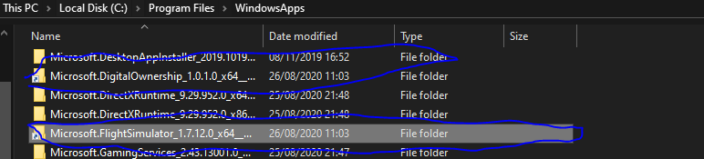

    So, I bought MSFS2020 gamepass to test it out for only £1 anyway, I started the installation, left it on overnight and woke up and its all installed fine. At first I tried to just hit continue as the game was still open so I did and this happened: https://gyazo.com/1cbad08bf7659e143e383ceb08865adc
    Oh ok, then I restarted and relaunched the PC now, it loads in all the way to the "checking for updates" screen then the loading bar freezes and I have to kill it in task manager. The only way I can get past this is to delete the most recently modified file inside of the installation files however this produces the same error mentioned in the above paragraph.
    I did some investigating and found that I had two windowsapps, one in the D drive one I wanted it in and one in the C drive with MSFS2020 in it aswell. So launched via administrator and looked what app it was launching, it was the C drive launcher instead of the D drive one. So it was launching the C drive .exe but I believe it was supposed to launch the D drive one.
    TLMicrosoft Flight Sim 2020 MSFS2020 Freezing on "Checking for updates" And possibly... :DR Game either freezes when you hit continue after installation and when you relaunch gets stuck at checking for updates also launches the wrong .exe.
    My drive, with the app installed it should be running it out from here but instead runs it out of the C Drive.
    Microsoft Flight Sim 2020 MSFS2020 Freezing on "Checking for updates" And possibly... ba29864f-9a5f-4fca-ac88-d8d0aba27174?upload=true.png
    C Drive one its launching out of
    Microsoft Flight Sim 2020 MSFS2020 Freezing on "Checking for updates" And possibly... 4572a4ea-7952-45a7-aa88-db6057776d85?upload=true.png
