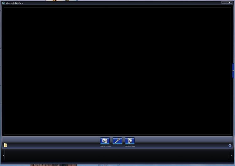

    Back in September 2015 I had a similar problem: Microsoft's LifeCam HD-3000 webcam stopped working when I 'upgraded' from Windows 7 to Win 10. However, a thread on Windows Ten Forums solved the problem. *Party
    So I've been a happy camper for the last 17 month. That is until the Windows 10 Anniversary Update. At least I am pretty sure that's when the LifeCam stopped working. The cam itself does not seem to be the problem--the little blue light comes on when it is engaged, the LifeCam software boots up fine, but, unfortunately, this is what I see:
    Microsoft lifecame hd 3000 still not working.driver says error and cam won't work.is this... 949133t-lifecam-hd-3000-stopped-working-after-windows-10-anniversary-update-lifecam_black_screen.jpg

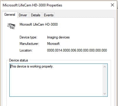

    The webcam is appropriately connected to a USB 2.0 port and, according to Windows, it is functioning properly:
    Microsoft lifecame hd 3000 still not working.driver says error and cam won't work.is this... -hd-3000-stopped-working-after-windows-10-anniversary-update-lifecam_the-device-working-properly.jpg
    The webcam also does not work via the Windows 10 Camera app, and on a video chat site (black screen on both).
    I have detailed my attempts to fix this problem over on the Microsoft Support site: Need help troubleshooting Microsoft LifeCam HD-3000 Not Working
    Can you all think of anything else I can do?

  3. Microsoft Lifecam HD 3000 windows 10 driver
    Hello, my name is Bradford, I'm an Independent Advisor for the Microsoft Community and I will try to assist you. Post, Windows 7, there are no signed drivers for the Lifecam HD 3000, however, built into Windows there is a generic webcam driver that might
    get your Lifecams working again.
    Please follow these steps:
    1. Open "Device Manager".
    2. Expand "Imaging devices".
    3. Locate the name of your "Lifecam HD 3000 camera" in the list and right-click on it.
    4. Select Update Driver Software.
    5. Click Browse my computer for driver software.
    6. Click Let me pick from a list of device drivers on my computer.
    7. Check Show compatible hardware, and then select "USB Video Device".
    8. Click Next and follow the on-screen instructions to update the driver.
    Please let me know if the above solution helps you to solve the problem.
