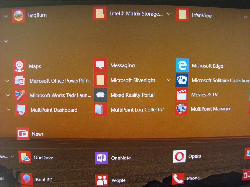

    Thank you for your reply. There are three menu items Multipoint in the Start Menu>Programs:
    • MultiPoint Dashboard
    • MultiPoint Log Collector
    • MultiPoint Manager

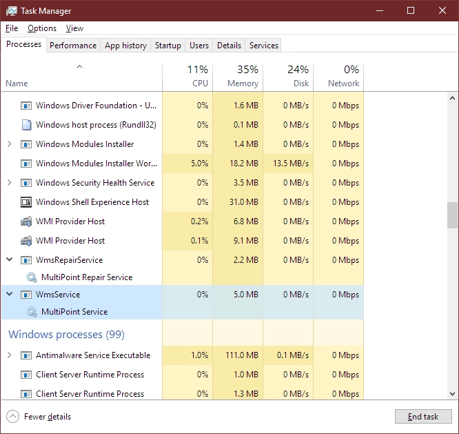

    When I click the
    • MultiPoint Dashboard link in the Start Menu, there is no indication that anything happens, however the linked program, "%ProgramFiles%\Windows MultiPoint Server shows up in the Task Manager as running.

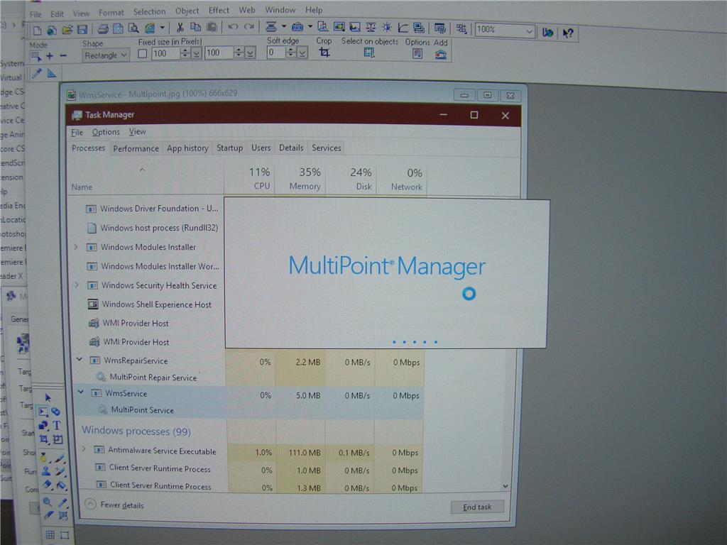

    • MultiPoint Manager selected from the Start Menu, brings up a small notification window that indicates that MultiPoint Manager is being accessed. It takes a long time for the error message to popup.

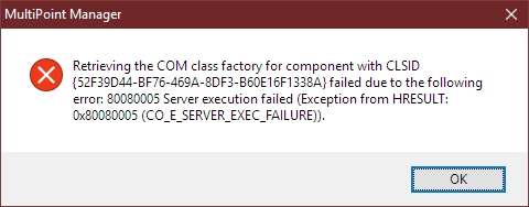

    • The final image below is a screen capture of the error message created by the Windows MultiPoint Server Manager when it fails to load.

    Microsoft-Windows-MultiPoint-Connector failed to be turned off. Status: 0x800f0922. d74a8119-420a-45e8-8566-a1650563b122.jpg
    Microsoft-Windows-MultiPoint-Connector failed to be turned off. Status: 0x800f0922. c5632dc7-9a0e-4575-b6a4-85cc84c01f19.jpg
    Microsoft-Windows-MultiPoint-Connector failed to be turned off. Status: 0x800f0922. f2d17554-ca64-4765-822f-89cdc407a3e2.jpg
    Microsoft-Windows-MultiPoint-Connector failed to be turned off. Status: 0x800f0922. c839dcbe-47ec-414a-968f-6c221741e78e.jpg
