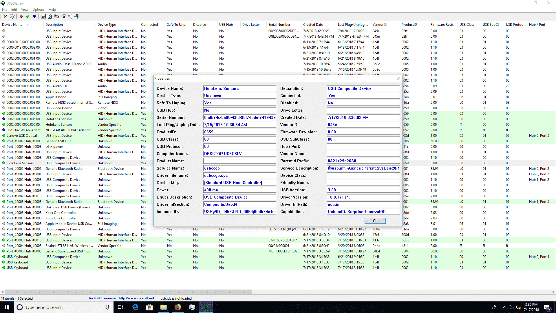

    I have recently acquired a Dell Windows Mixed Reality visor. After 4 days, I have not been able to get the thing set up. After running the WMR portal, it tells me to check my display cable. If I plug the visor into my HDMI out port it shows up as a monitor. When I plug it into one of my USB 3.0 ports, it shows up as the Dell visor, but Device Manager constantly refreshes. That is the result after plugging the visor into every USB port on my computer. This leads me to believe the problem is being caused by communication issues between the visor and PC through the USB cord or ports.

    - My USB 3.0 ports might not be providing enough power. WMR requires a USB 3.0 connection with 900ma supplied through the USB. After plugging in the visor through USB, Devices and Printers claims that the visor is running on a 3.0 USB connection. To investigate further, I used a free program called USBDeview to access more information about my USB ports. It agrees with Devices and Printers that it is running on a USB 3.0 connection, but claims that my USB port is only supplying 400ma to the headset. The screenshot attached demonstrates this. I have no clue how to get my PC to supply more power to the USB. Maybe the headset just isn't pulling as much power as it needs, even though my PC can supply it.
