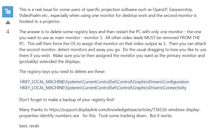

  3. BobGHW Win User
    WIN 10 incorrectly identifying monitors
    Hi thanks for the reply, Yes did all that also did the instructions in attached doc, which also didn't work. As soon as I plugged in the secondary monitor it became the primary????
    The only thing that worked was to delete registry keys restart with main monitor attached and add a different secondary monitor a dell not the original HP secondary.
