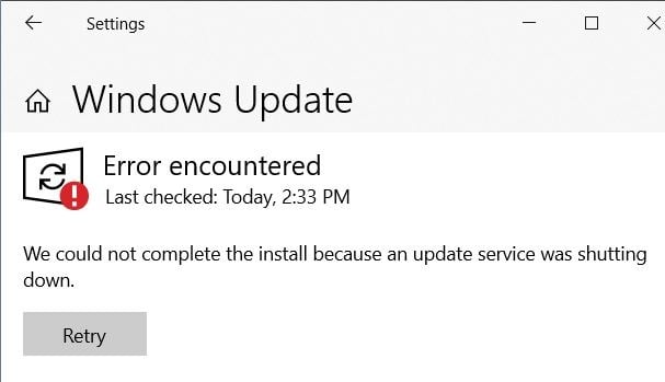

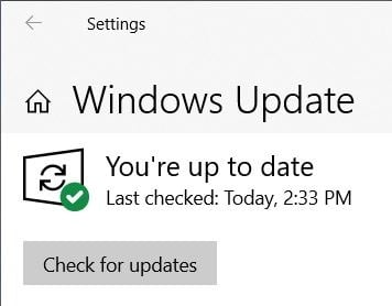

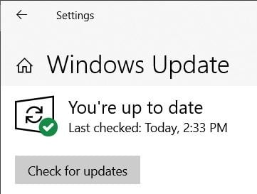

    I just got that and then went into Windows Update
    MoUsoCoreWorker.exe Preventing Monitors from turning off 322382d1615584990t-should-mousocoreworker-exe-preventing-sleep-ignored-2021_03_12_21_36_291.jpg
    MoUsoCoreWorker.exe Preventing Monitors from turning off 322383d1615585012t-should-mousocoreworker-exe-preventing-sleep-ignored-2021_03_12_21_36_523.jpg
    MoUsoCoreWorker.exe Preventing Monitors from turning off 322384d1615585020t-should-mousocoreworker-exe-preventing-sleep-ignored-2021_03_12_21_37_004.jpg
    All seemed OK but based on past experience I knew there was something wrong with Windows Updates

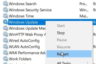

    I then restarted the Windows Update service

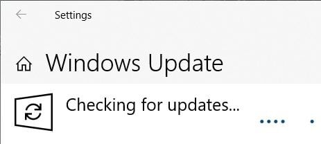

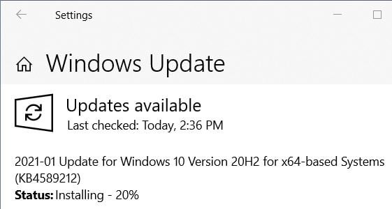

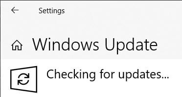

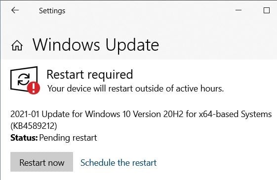

    I then retried Windows Update again
    MoUsoCoreWorker.exe Preventing Monitors from turning off 322387d1615585322t-should-mousocoreworker-exe-preventing-sleep-ignored-2021_03_12_21_42_021.jpg
    MoUsoCoreWorker.exe Preventing Monitors from turning off 322388d1615585339t-should-mousocoreworker-exe-preventing-sleep-ignored-2021_03_12_21_42_192.jpg
    MoUsoCoreWorker.exe Preventing Monitors from turning off 322389d1615585346t-should-mousocoreworker-exe-preventing-sleep-ignored-2021_03_12_21_42_253.jpg
    MoUsoCoreWorker.exe Preventing Monitors from turning off 322390d1615585356t-should-mousocoreworker-exe-preventing-sleep-ignored-2021_03_12_21_42_354.jpg
    That showed there actually was a problem with Windows Update.
