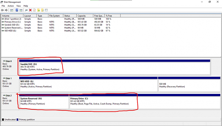

    I had just install a new m.2 NVMe card yesterday and had cloned my primary drive over to the m.2. It was working wonderfully and was booting up okay then I had decided to clear the original primary drive. I had then tried updating windows from settings and when it tried to boot up I got an error saying bootmgr was missing. I had reinstalled windows with the media creation tool back onto the original drive after it wouldn't let me install onto the m.2. I now boot from the original drive then it goes to a screen saying there are two volumes that retain a copy of windows. I select the first one and I notice Its running from my m.2 as per the image. It shows boot and is the C: drive but the other disk that i boot from still says system in the partition.
    I would like to know how I can safely move the system partition over to my m.2 and boot from it without it asking for a volume to select when starting. Please and thank you!
    Moving the System Reserved Partition to another disc so that i can install a new M.2... 309003d1606955307t-move-system-partition-system-reserve-partition-annotation-2020-12-02-162815.png
    Coverttrickster, Aug 28, 2023
