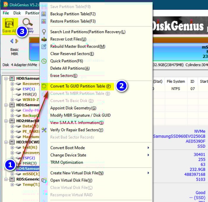

    You can do what @NavyLCDR said in post #8 ie. Install with MBR disk type provided that your current MBR disk have less than 4 partitions.
    or if you still want to install with GPT disk type then
    The easiest way without doing all the steps above is:
    1. Download from my google drive: DiskGenius.7z - Google Drive
      Format a USB with FAT32 and set it to active
      Unzip DiskGenius.7z to the root of the USB
    2. Boot up. Right click on the Drive that you want to install Windows ->Convert to GUID partition table then click on Save All. This will convert the disk to GPT disk without losing Data
      "MRB", "EFI" and "GPT" problem when trying to Clean-Install W11 onto my Dell laptop. 260794d1577400075t-problem-w10-install-efi-gpt-mbr-issue-2019-12-26_143523.jpg
    3. Once done. Boot up your installation disk to continue the installation.
    topgundcp, Mar 15, 2024
