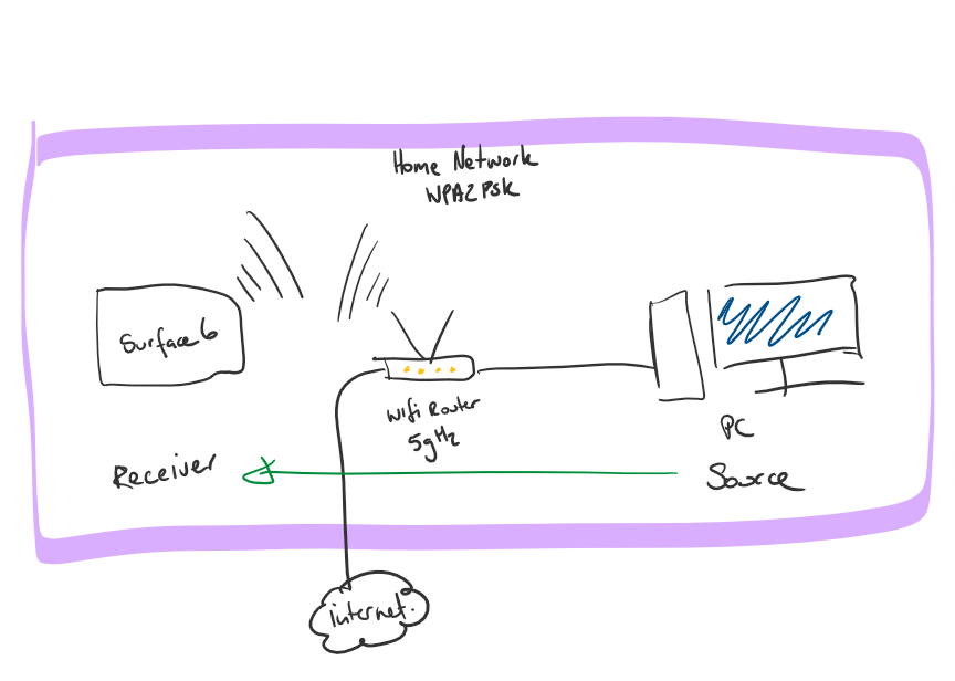

  4. MS-MICE Miracast over Infrastructure
    Miracast over Infrastructure from ethernet Win 10 PC to Wifi Surface 6.
    Aim: use my Surface 6 as a second monitor to extend the display of my PC via Miracast over Infrastructure.
    Setup: Desktop PC with nVidia 1070 graphics. Windows 10 1903, connected to Wifi router/switch via ethernet. No wifi card. Surface 6 Pro, Windows 10 1903 connected to same Wifi router via 5Ghz secured with WPA2PSK. Devices can see each other
    on the private network.
    Troubleshooting:
    I cannot seem to project from my desktop to my surface, the Connect App on the surface reports it is available to receive. The PC Connect action centre applet says it is not setup for Miracast. I have searched Technet, stackexchange and MS support for assistance
    with MS-MICE. The problem appears to be with the Miracast Source. Some suggest that the initial setup needs to be entirely over wifi before transitioning to infrastructure, some detail must be WPA2PSK or WPA2Enterprise, others talk about "same Enterprise network",
    suggesting this might be a domain specific technology rather than of-the-shelf consumer network. Most of the information is about Surface Hub, which is a whiteboard sized Surface, rather than a Surface Pro.
    Question: How do I use extant infrastructure to extend my display to my Surface 6?
    Diagram:
    MS-MICE Miracast over Infrastructure b3f1bbce-0288-4e37-a155-244b5910afa5?upload=true.png
    Drew Triebe, Apr 25, 2022
