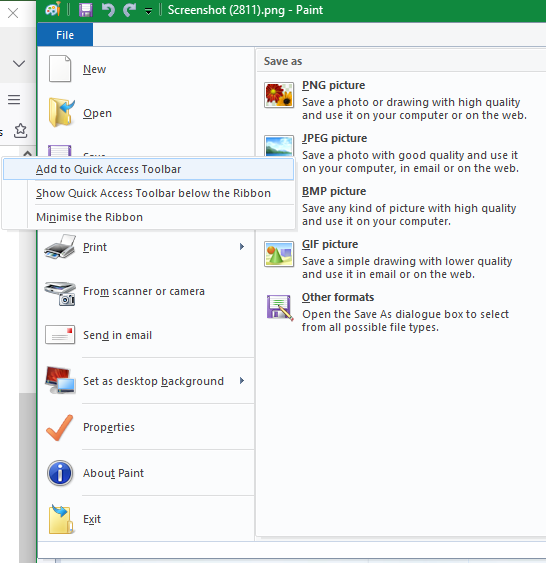

    Change MS Paint default save format to JPG
    As Les says, there is a way to add SaveAsJPG to your MSPaint Quick access toolbar. - As far as I am aware, this is the closest that you can get to what you said you wanted. - This applies to MSPaint not to Paint3D - WayneConfidential's 2011 solution is just about the same now and I've described the procedure below. 1 Open MSPaint [C:\Windows\System32\mspaint.exe] 2 Select the File menu in the upper-left 3 Hover over the SaveAs menu entry 4 Right-click on the desired format & select Add to Quick access toolbar
    MS Paint default file save type to JPG? 8559d1696492925t-change-ms-paint-default-save-format-jpg-paint-saveas-right-click-desired-option.png
    5 Its icon is added to the right-hand side of the QAT

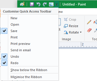

    6 To alter its position, for example to put it next to the default Save icon, click on the dropdown symbol at the very right-hand end of the QAT and remove any other icons that appear to its left. They can be re-added afterwards because all newly-added icons get added to the right-hand end.
    MS Paint default file save type to JPG? 398561d1696493075t-change-ms-paint-default-save-format-jpg-paint-qat-customise-qat.png
    MS Paint default file save type to JPG? 398562d1696493113t-change-ms-paint-default-save-format-jpg-paint-qat-revised.png

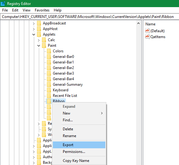

    7 Once you've done the job, you can back up your modified QAT in order to restore it to this or another Windows 10 or 11 computer. 7.1 Run RegEdit [C:\Windows\regedit.exe] 7.2 Double-click on the word Computer in its address bar to select it
    MS Paint default file save type to JPG? 398564d1696495119t-change-ms-paint-default-save-format-jpg-7.2-select-regedit-address-bar.png
    7.3 Paste in Code:
    and press the Return on your keyboard to take you there. 7.4 Right-click on the Ribbon Registry Key itself in the left-hand pane and select Export
    MS Paint default file save type to JPG? 398566d1696495356t-change-ms-paint-default-save-format-jpg-7.4-right-click-ribbon-select-export.png

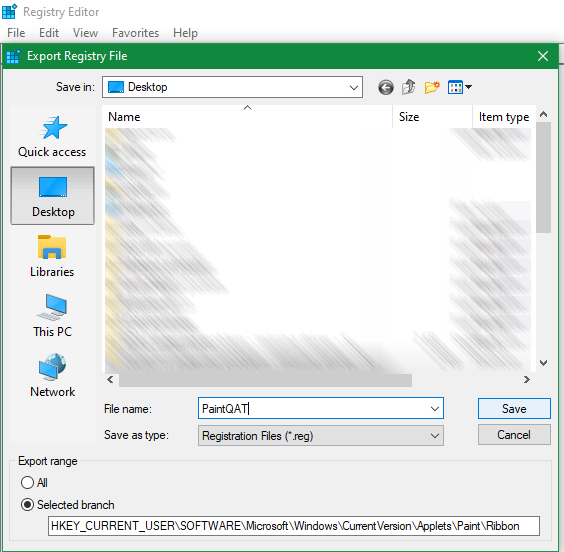

    7.5 Browse to a folder, enter a filename, click on Save
    MS Paint default file save type to JPG? d1696495588t-change-ms-paint-default-save-format-jpg-7.5-browse-folder-enter-filename-click-save.png

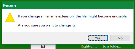

    7.6 I then always add .txt to the end of the filename so I cannot accidentally run it [we actually say merge rather than run for .reg files]
    MS Paint default file save type to JPG? 398570d1696495957t-change-ms-paint-default-save-format-jpg-7.6-1.png
    MS Paint default file save type to JPG? 398571d1696495970t-change-ms-paint-default-save-format-jpg-7.6-2.png
    MS Paint default file save type to JPG? 398572d1696495987t-change-ms-paint-default-save-format-jpg-7.6-3.png
    7.7 If I ever want to restore my modified PaintQAT or set it up in another Windows 10 computer, I close MSPaint then remove the .txt that I had added and double-click the .reg file. There are two confirmation dialogs to get through and then the entries that existed when you did the Export get re-written in the Registry. I have just, for example, done this on another Windows 10 computer so that it is set up the same way as my main day-to-day computer and its PaintQAT now looks the same as this one.
