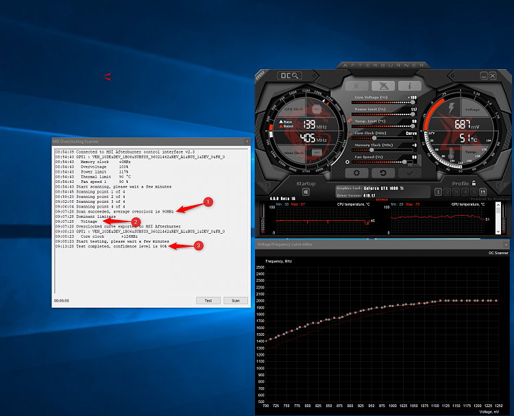

    Latest MSI Afterburner Betas & Updates
    90% is the highest rating Unwinder said.
    This is from Nvidia, as the OC software is theirs, and not MSI'S.
    By the way Doug, the OC scanner is only for the core clock, and for stability, not the highest possible clock.
    #So it's recommended to use your normal fan curve and highest stabile memory clock setting when running the scan, as the heat generated from memory and core voltage will affect the core stability if you up them later.
    So basically set up your profile for gaming use, but leave core clock at zero, then run the scan.
    The core OC might not be as high, but more stabile over time, which is the most important, right?
